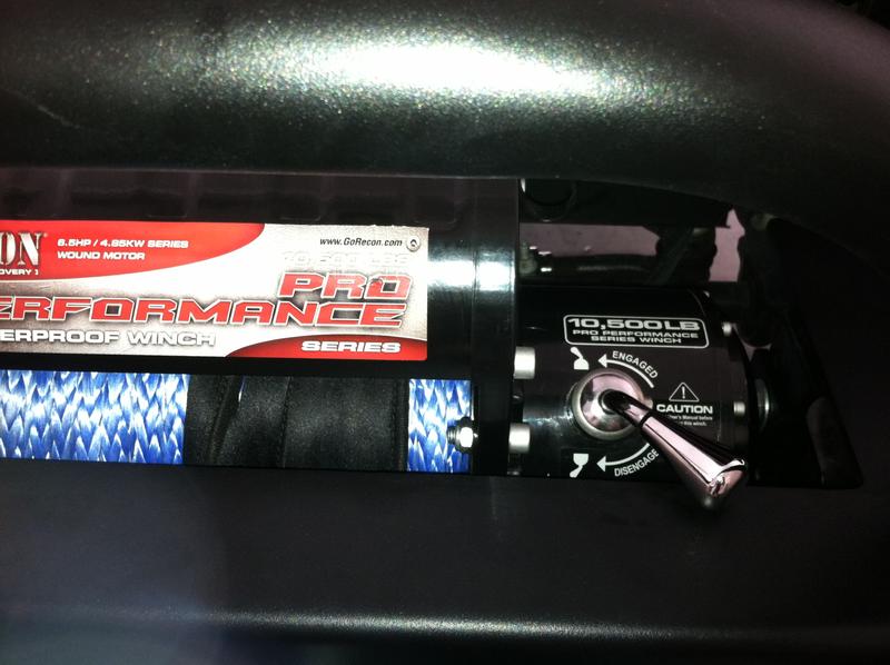

The hardest part of this was trying to tighten the outer most bolts on the bumper. There is simply little to no space to get your hand in there. I added lock washers to help create tension but it still took close to an hour of messing with it before I felt comfortable they were secure. The other issue I had was with two of the bolts on the skid plate. Two of the rear holes did not align properly so I had to drill them a bit so the provided bolts would fit. Note- the holes on the skid plate were fine, it was the piece of metal the rear part of the skid plate attached to that I had to modify a bit. Finally, the lever to engage/disengage the winch will not completely disengage once you install the winch using the pre-drilled holes on the winch plate. I have provided a picture below. I do not think this will be a problem, but if anyone has input, I'm all ears.

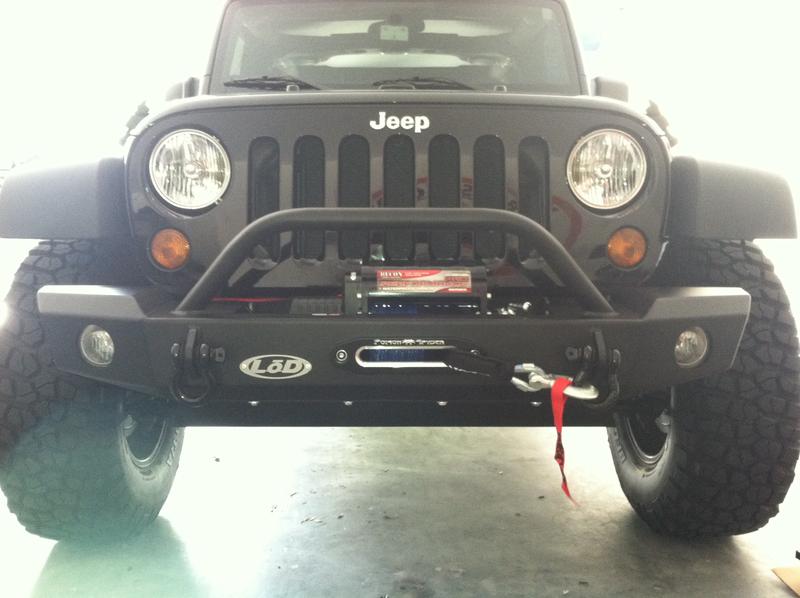

Once I was done, I went back and checked the tension on all bolts to make sure everything was sound. Wiring and testing the winch took 20 minutes. I have provided a couple of pics below. I would suggest using the write-ups here in the forum for this project. They are great guides. I have the Generation 3 LoD rear bumper with tire carrier waiting in my garage (just came last week). This one will take some help.

Looks good man

Great job. Can't wait to get mine!

wow, that is a long time! Looks great. You better plan on about 12 hrs. for the rear if it took you 8 for the front. I would suggest using the write up on here as well as the write up on the LoD website for that install.

...Finally, the lever to engage/disengage the winch will not completely disengage once you install the winch using the pre-drilled holes on the winch plate. I have provided a picture below. I do not think this will be a problem, but if anyone has input, I'm all ears.
Congrats and good job. Regarding the lever on your Recon, I have the same issue with my full length LoD. I have not had any problems with the lever, or disengagement of the winch. Originally I planned to rotate the housing unit that has the lever in it, clockwise, but have not gotten around to taking apart the winch, nor has the need to rotate it come about. It works as is.
I appreciate the response. Being unfamiliar with winches, I was a bit worried it might engage accidentally or draw from the battery when not in operation. I'll probably leave it as-is unless something comes up. Thanks again!
