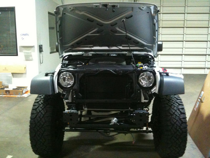

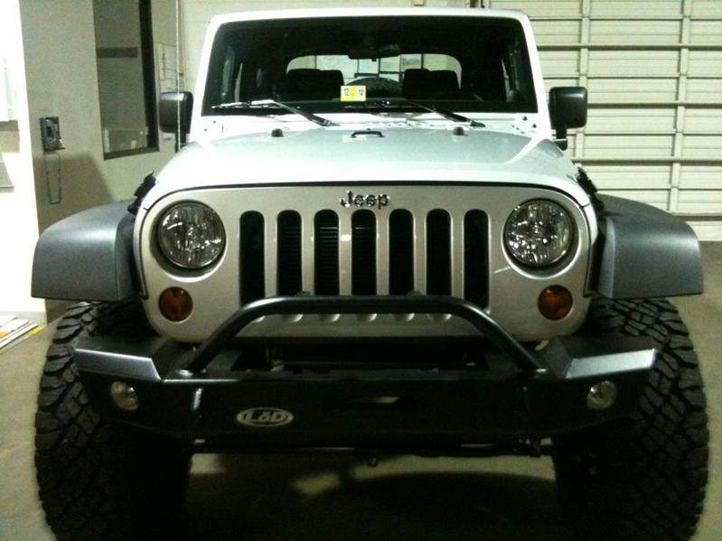

But the cables don't reach the fog lites now WTF!
Any suggestions?

You might have to lengthen the wires.

Just cut the wires near the plugs and splice some wire in to extend them, then shrink wrap to waterproof them. Very easy. I did the same with my Expedition One bumper

Yup. I have the Mopar bumper and pretty much once you move the lights outside the crush can / frame area you're going to have lengthen the stock wiring.

You DON'T have to cut the wires. Look under neat the front of the vehicle and follow the wires from the fog lights back to the frame rail. You will see a plastic wire loom. Open up the loom and you can split the wires further back giving you more length. Then just add new wire loom to protect the wires.

You do not need to splcie or cut, just un-tape the plastic tube cover around the center cross member and pull out the slack. I ahve this bumper and did not cut the wires.
