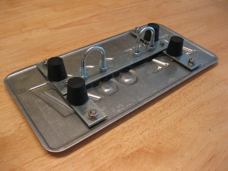

  • Currently have license plate zip tied to the grill. Better location?

There are very few options for mounting your plate to the Hawse fairlead. Roc Dog Fab makes a bracket, however I just made my own for about $10. I remember seeing another innovative home-made bracket on the forum, but don't recall which thread it is posted.
