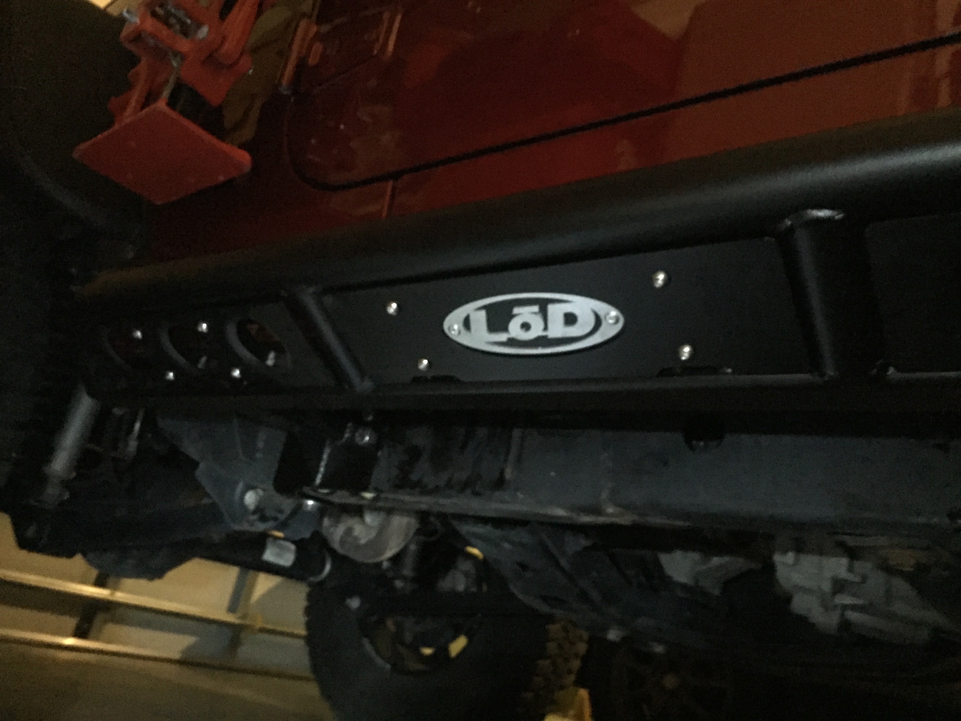

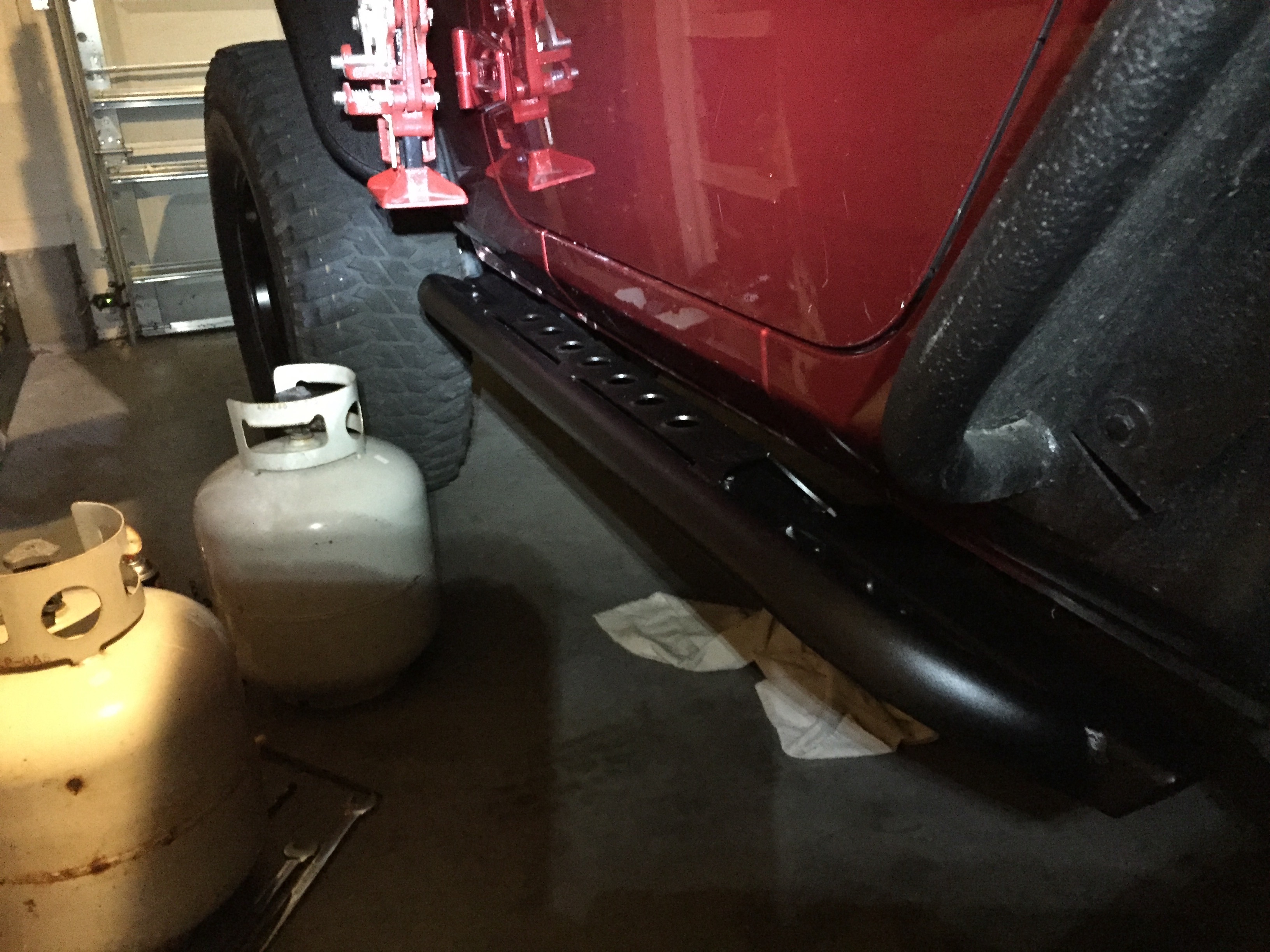

I decided to move ahead with the install. So far I have one installed. I think I'm going to be short a bolt since I had to use one that came with the sliders. I used Propane tanks and textbooks to hold the sliders in place....lol
ID:	635150   Click image for larger version

I like your ingenuity... you can always pick up a couple of bolts and put them on afterwards... as long as you stay off the rocks you'll be fine until then!!

So I'm as far as I can go today. I work near a Fasenal Store, So tomorrow I'll get the bolts there hopefully. I was 2 Bolts short to complete. Funny thing is they sent me 2 extra allen bolts for mounting the side plates...... oh well... These things are freaking heavy duty. I'm very pleased with this upgrade.
