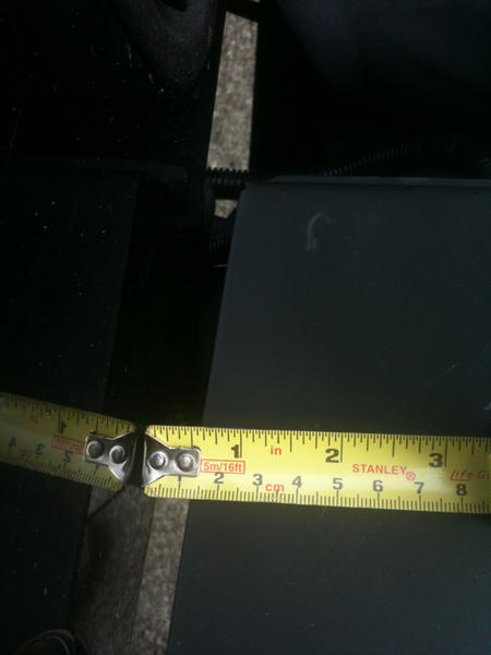

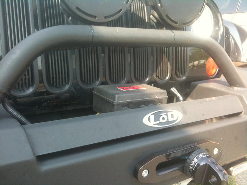

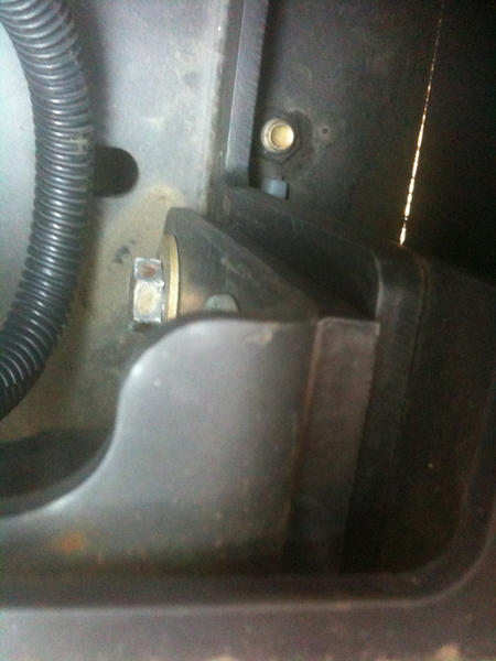

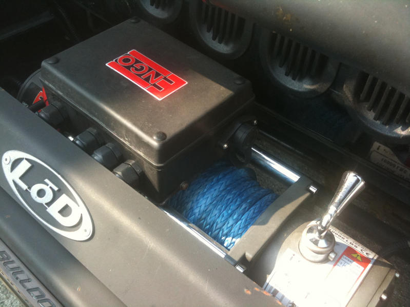

You dont seem to have the gap. Humm, probably going to call LOD on monday and share the pictures with them.
The gap on mine is about 1/2in with the spacer installed between the frame and the winch plate, which is next to the bumper. Took several photos today in different angles.
I notice you and I have two different LOD's. You certainly have less space than I do. I have about an inch and a half. Im going to call them tomorrow. I hope I did something stupid with the install and its not worse.
thanks for taking the time to post the pics.
Welcome! Mine is the full-width. However, they have different gens. Mine is one of the older ones. Good luck!

SPoke to LOD today. Again, these guys are great.
When you install the bumper you need to first install the winch plate. DOnt do what I did and install the plate first and the spacers second. THis is why I have little room for the solenoid cables on the winch. The spacer should go between the frame and the winch plate. The instructions are clear on this. I just screwed up. If you dont mind the winch cabes resting on the grill, you can skip using the spacers and have the bumper sit 3/8th of an inch closer.
You may notice that the skid plate has nothing to screw into on the back left side. LOD informed me that its adjustable nd you are actually supposed to drill your own holes. I left the far left bolt off. Its on there so strong that I didnt see a need to drill.
The bumper itself is adjustable left and right. The holes are oblong to give you the ability to center it. Make sure you do this before you tighten everything down.

Well...as you can see on my photos, I placed the spacers between the frame and which plate and still did not have space for the cables so had to reverse the control box.
Only way for mine to move forward would be drilling all four holes and, sincerely, that plate is thick. Reversing the control box was faster and easier. ;-)
