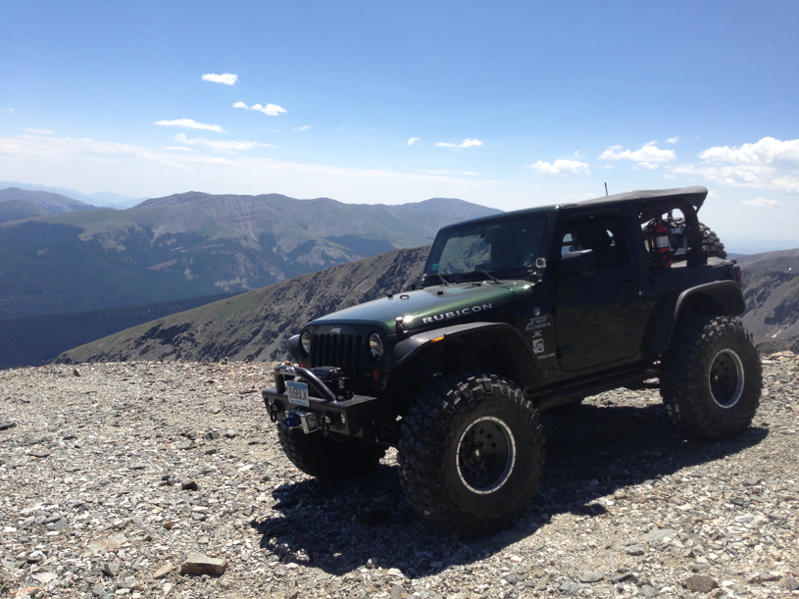

Here's a short arm that does well. Only struggled in places where we were rock crawling and mainly due to being a two door

i wouldnt worry about it unless your over 4" of lift. They dont gain any flex just improve onroad handling and allow the tires to not pull towards the vehicle as much when drooping..On the jks the control arms are at alot better angles than the tjs, so it not as much as a necessity.
