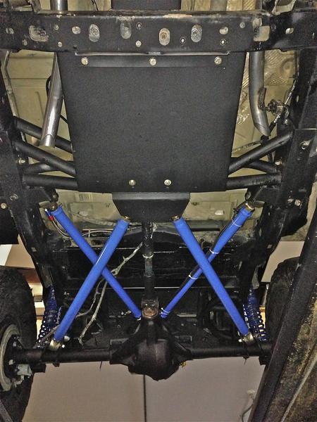

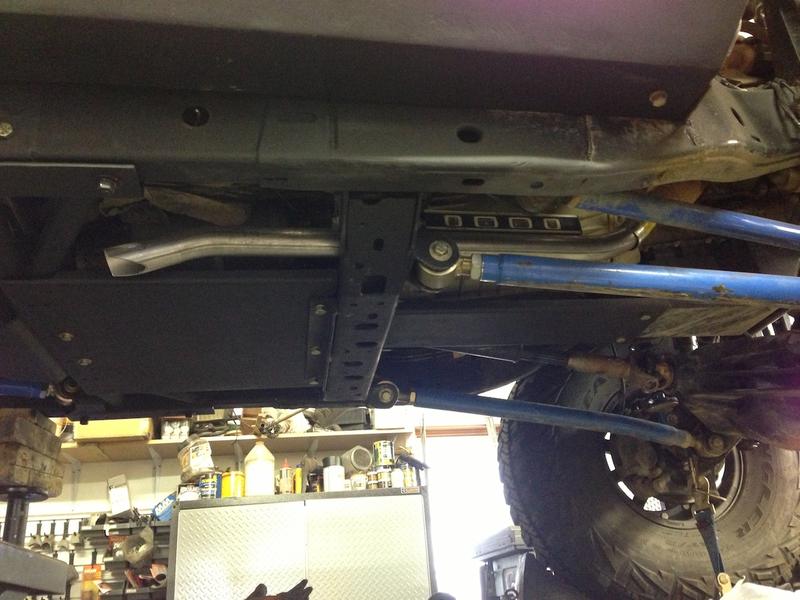

clayton makes a cross member that the links mount into and look at synergy and genright. Or you could just build your own, its really not that hard if you can weld and have some knowledge of how a suspension works. If looking at a kit that bolts the links to the cross member I would make sure to beef up the weak factory mounts. I have my front lower arms mounted to a poison spyder cross member.

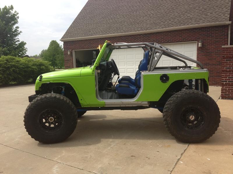

Do you have a build thread for your jk?
