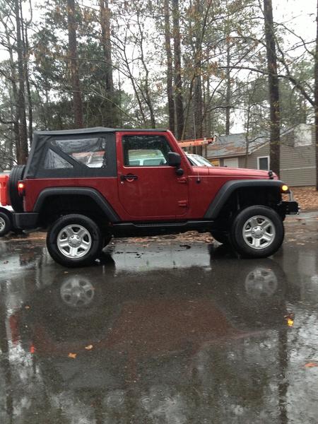

This is how ridiculous a Jeep looks with a Lift and the incorrect tire size.

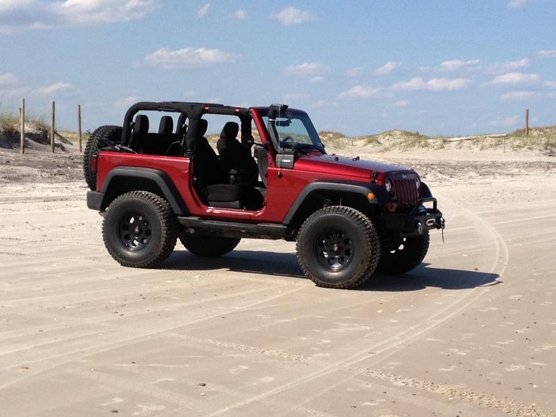

This is how it looks with the correct tires.
