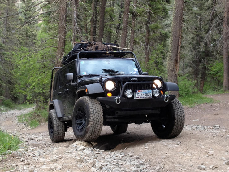

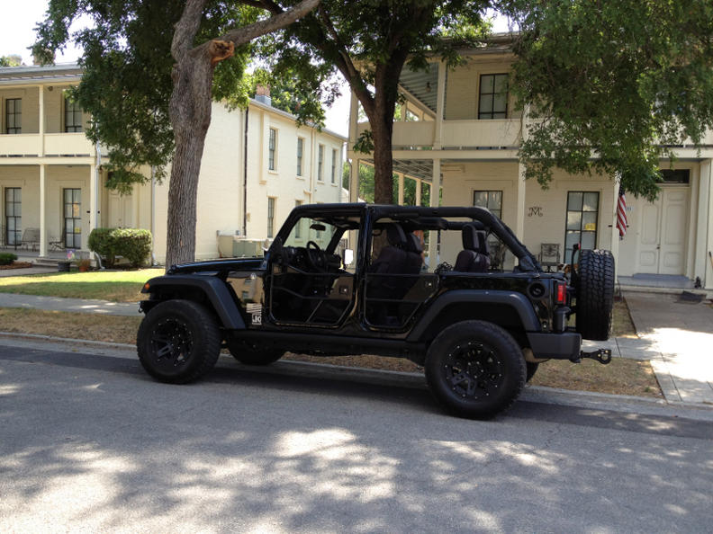

I am running 33s. Rims have 4.5 backspace. They fit without a lift, but would rub if I wanted to wheel.
I got a 2" BDS lift. Here are the pics.
Hope this helps.
Last time I went wheeling, I occasionally rubbed the rubicon rock rail with the rear tire. So, if you want to run 33s, you might want to consider 2.5 in lift.

Buddy of mine just added 33s and made a huge appearance improvement from stock. Kept the stock wheels.
Hope this helps.
Good luck.
