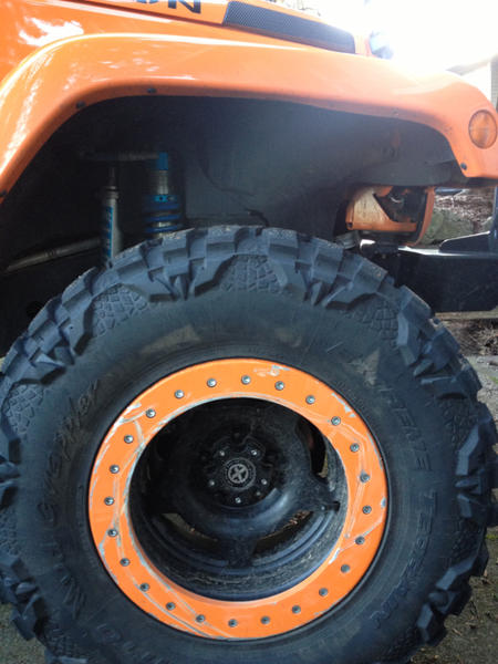

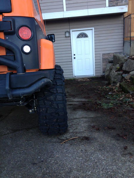

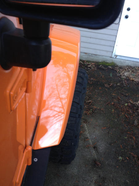

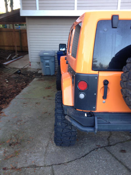

3.5" is the correct backspacing; you've got to have it to prevent rubbing. Sticking outedness is the price we all have to pay.
Double beadlocks sound really cool, but I've never met or spoken to anyone that could tell me why they are necessary.
If you didn't run a 5th beadlock, what would you run for a spare? I was out wheeling last fall and watched a buddy pop his tire. We replaced it and continued wheeling, an hour later, he popped a second tire. (Non beadlocks). The likelihood of losing a tire is higher on the trail, and you'd need to be just as capable with the spare as with the original wheel.

Thanks for the input. Sounds like ATX Slabs. My worry was with only outer beadlocks you can still pop the inner bead off, but it sounds like that really doesn't happen. True? I like the Hutchinson beadlock but it only comes in a 4.63" bs. Not enough without spacers and I want to ditch the spacers I'm using now.
Nwapache, what size tires are you running? Thanks for posting the pics.

I'm running 35" mud grapplers. I know there was a special going on the slabs a couple of weeks ago. Call NR4x4 and see if it's still available
