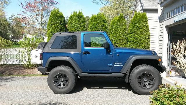

I run the 2.5" AEVwith 315/70/17 duratracs and I like it fine. The ride is a little firm, but it corners better than I could ever expect it to and I hear with heavier bumpers the ride would settle down a bit. I wish I could compare the ride to Rock Krawler or Metal Cloak. I've done greens at RC with no issues, but that's not really saying much lol. I plan to push it harder at this year's JK Freak Fest in May(great event - you should try to come) so we will see how it goes. I'll likely try to sell the Jeep after Freak Fest and get into a new Rubi like I'd mentioned to you a few weeks ago and I'll probably go Rock Krawler or Metal Cloak on that one.
Oh and as far as gearing goes I run 3.73 and it's livable, but maybe only because I've never driven one properly geared.
