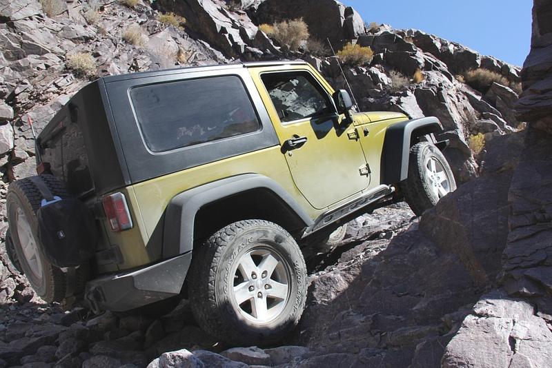

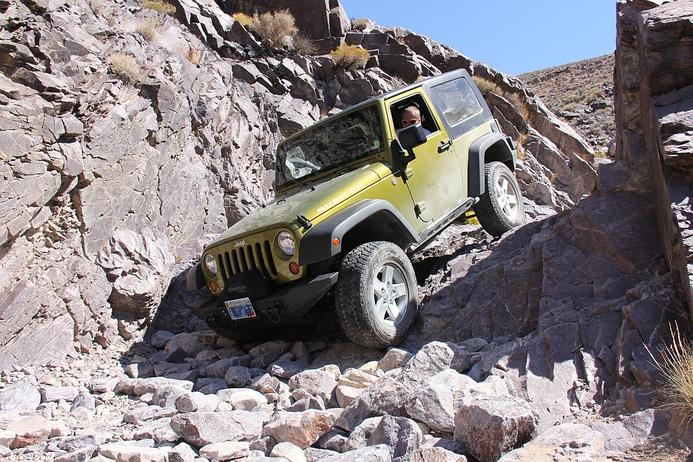

Mine is used as for expedition-mild rocks, see my profile for specifics. Below is what I'd call mild rock crawling with just 32" tires and a 2" lift, and a Rubi does pretty well just stock too. Currently it has 33" tires, and for long trips it still gets 19+ MPG on the highway with the 3.8L engine.
