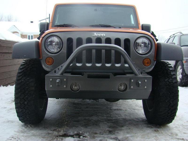

Just got a new synthetic winch, installed winch but were bolts are to install fairlead, they will hit winch if I line up, I can move fairlead over but then steel on one side is exposed, what could I do to fix this, looking for a creative fix, added a pic of my style bumper
What bumper is that. Looks good!

It is a rock hard fabs, not to be confused with rockhard. I will take a pic tomorrow to further explain

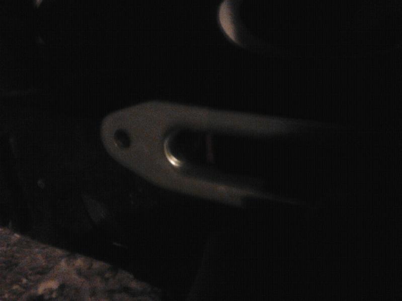

We had that issue and installed two carriage bolts to hold the fairlead on. We have a Rugged Ridge XHD bumper and a Smittybilt XRC 8 comp winch. Not sure if this will work for you but it's worth a shot!

Not sure if this helps but here is the way the fairlead would need to be to get both bolts in, sorry for bad night pic
