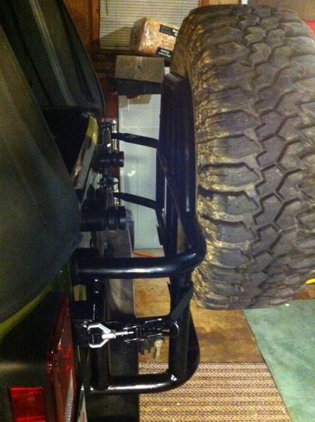

Well, the pics aren't very good.
There is a bar that bolts to the carrier itself. You put the wheel on there, then put the rubber "spacer thing" and then the plate followed by the T bar that's threaded. A better picture would do wonders. The rubber piece is to keep your wheel from getting tore up. the bar the wheel rests on has holes for a lock. You could easily have something made that screws into the mount and has lugs. There's a thread somewhere that shows it.

the rim rests on the carrier tube (the pipe stickin out)and is held on with the t bar in the second pic with a huge rubber backed plate. i welded the tab on there for added security since i heard some guys were finding theirs loosened by some dipshits. i love it, no rattles and very strong.
