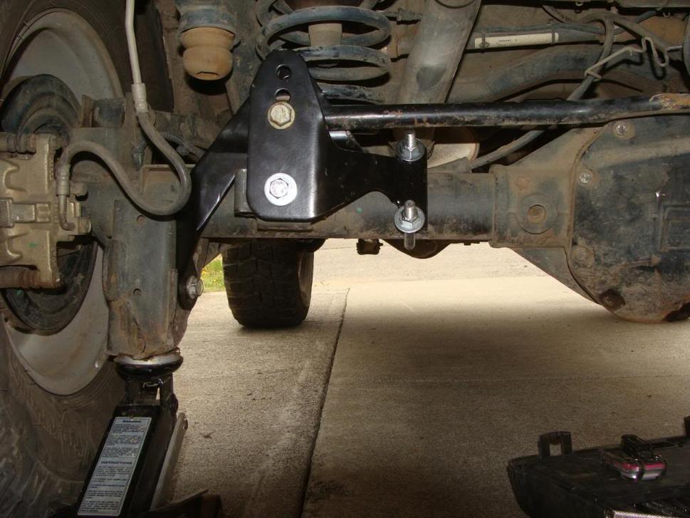

I have a Sky Jacker 2 ½ in lift had it for 1 year and 35's. Well today my rear factory track bar mount sheared off extension bracket is still attached I sent it by tow to the dealership I am Sure they are not going to cover it so I am looking for any and all pics of fixes for this issue. I am taking it to a welder in the afternoon I would love to have pics so he can see some of the best fixes you guys have come up with. There is not a 4x4 shop in this town and I do not want to tow it again to another town any help would so be appreciated. TY!

Stay away from SkyCrapper.
What you need is a trackbar bracket that is FRAME mounted, not axle mounted. Or, an adjustable trackbar.

SJ sent me the track bar brace but I am going to have to get the original jeep mount re-welded.
Trust me I am not a fan of SJ right now but I own it know and just need to find the best fix for what I have the Budget cannot handle a new lift.

mkjeep's Avatar
Posts: 15,665
From: Hammond Louisiana
https://www.jk-forum.com/forums/jk-show-tell-33/fixed-my-rear-trackbar-bracket-permanantly-76134/
I'll look for more, Tera makes a brace too.

If you do purchase a frame mounted bracket the Teraflex 2-3" bracket works great and centers the axle good, i used it on my SJ 2.5" lift before i took the lift off.Its not expensive either, Good Luck!

Teraflex brace ,axle one, that goes over factory one

Good thread on homade re-inforcement
https://www.jk-forum.com/forums/show...rack+bar+mount
