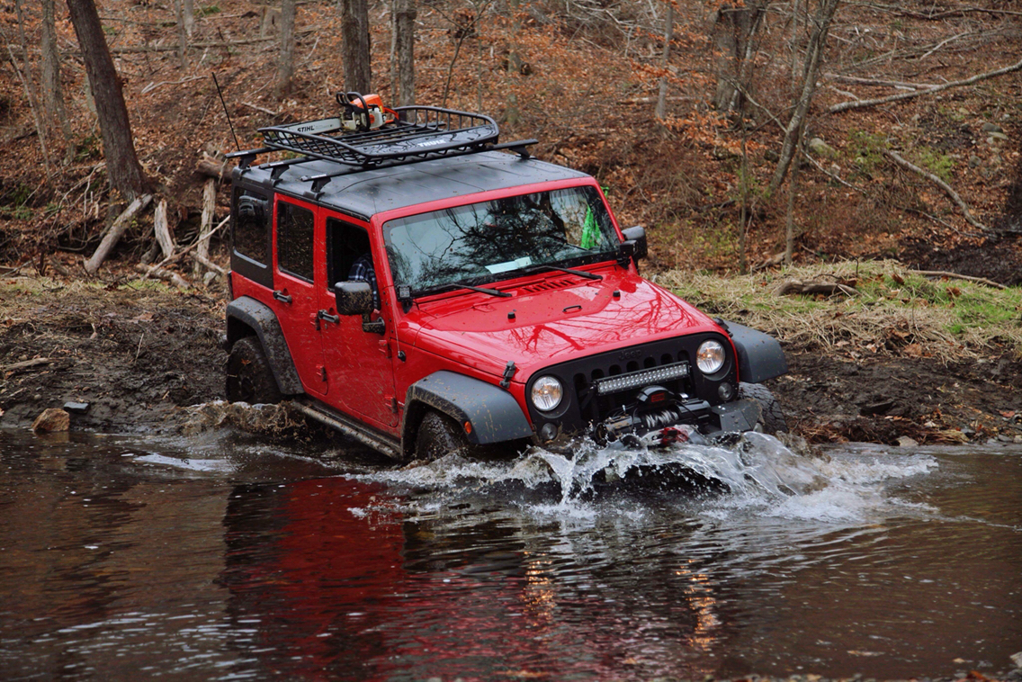

Please do yourself a favor and don't do a gutter rack... save your lunch money and look at the Rhino rack backbone or Teraflex Nebo system. Both are low profile and can actually accommodate a good static and moving load. The Rhino rack system can use either their pioneer platform or 3 of their crossbars to accommodate a myriad of accessories... I already had a basket so I went with the bars and have been extremely happy

What's wrong with a rain gutter mounted rack like the Smittybilt Defender? I used to have a full size Wild Boar rack, but found that I just didn't need that much rack. 150 lbs is enough weight for me up top.

There is a bit of a difference between the Defender rack in that it ties to the rear hinges and a true Yakima/Thlue gutter rack that mounts to the two piece freedom tops and small rain gutter section above the rear doors(4dr). The fiberglass top isnt exactly structural and for sure the rain gutters are not designed to take a load. Would you stand on the rain gutter? I guess in my mind I see a gutter rack, mounted, overloaded, in the woods and with all the body movement causing the rack to rip off the mounts. for my use, we load the basket up like crazy for road trips. With two kids a dog and a wife we often are bringing the kitchen sink, so having a higher capacity with a more integrated rack is what we were looking for and the rhino rack fit the bill...and 270LBs is more than enough for anything we could put up there.
