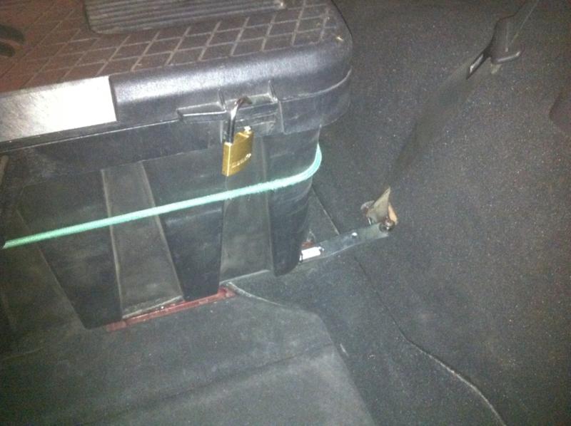

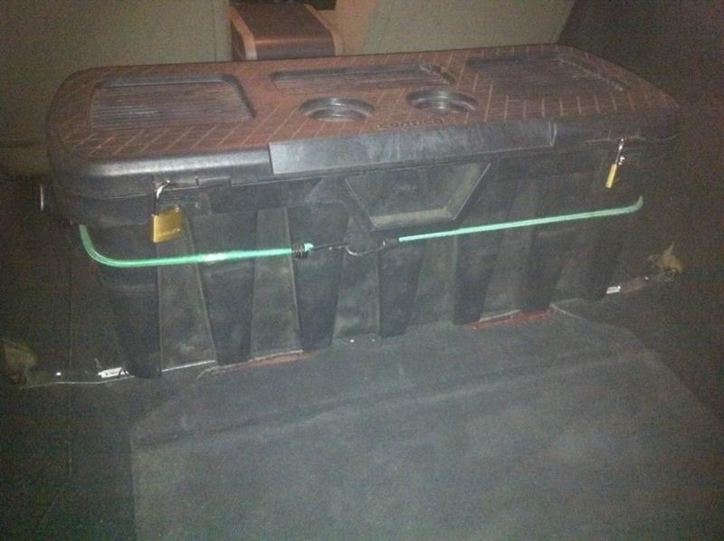

I've bolted a lock box to the rear seatbelt bolts. Simple to undo if I need to throw the rear seat on
ID:	123776   Click image for larger version

Looks like you fabricated a bracket to mount the box to. This is something I might consider doing, but I have an Unlimited, and I plan to keep my back seat.
