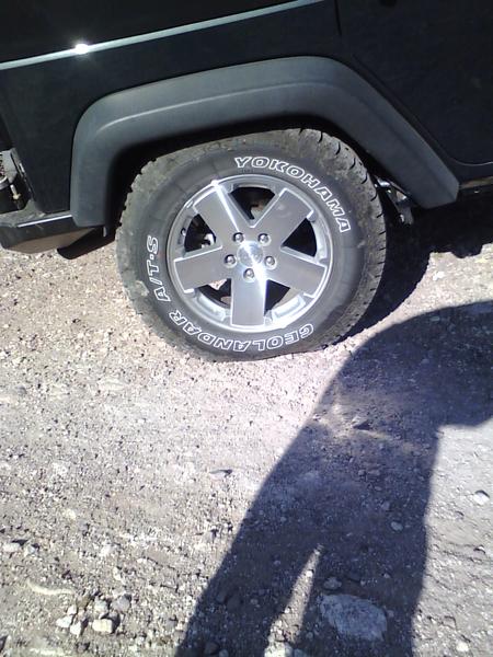

The left front tire is about 36" higher than the other 3 on this trail, the front sway bar is not disconnected, I just wanted to see the flex with the links connected.
The rear suspension is fully compressed. The rear tire is stuffed into the wheel well. but not rubbing. 35's would have rubbed the fender.
For crawling, I would regear if I went to 35's. With 33's, I am slipping the clutch a lot in 4 Lo in first gear.
