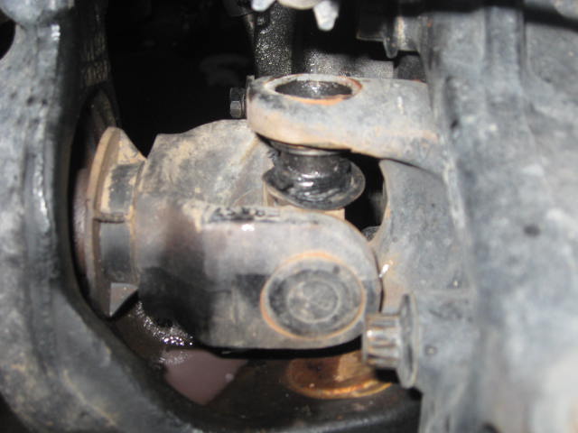

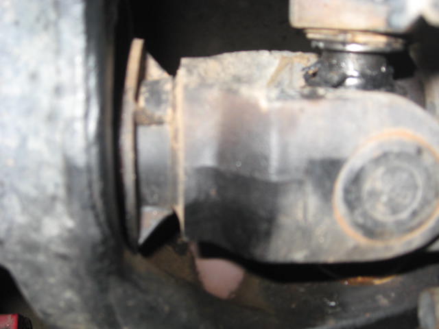

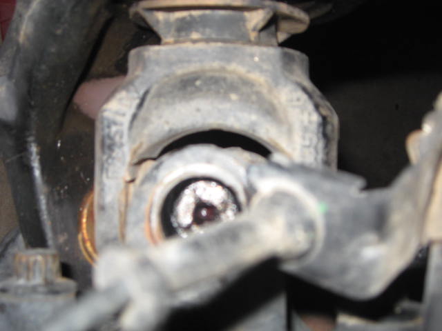

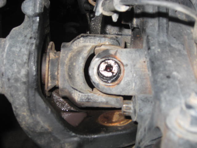

Lost my driver side axle u-joint
So I wasnt wheeling hard but started to hear some noises and checked when I got home and foud my u-joint pretty much gone. Now I am debating on going to the rcvs or just fix the u-joint and still have enough cash for gears and lockers
well if the hole is wallowed out then u will have to replace the outer stub and ujoint. if not then just replace the ujoint. u might as well replace entire shaft if u have to replace ore than ujoint.. price anywhere from $110-$180 depending on where u get it from.
