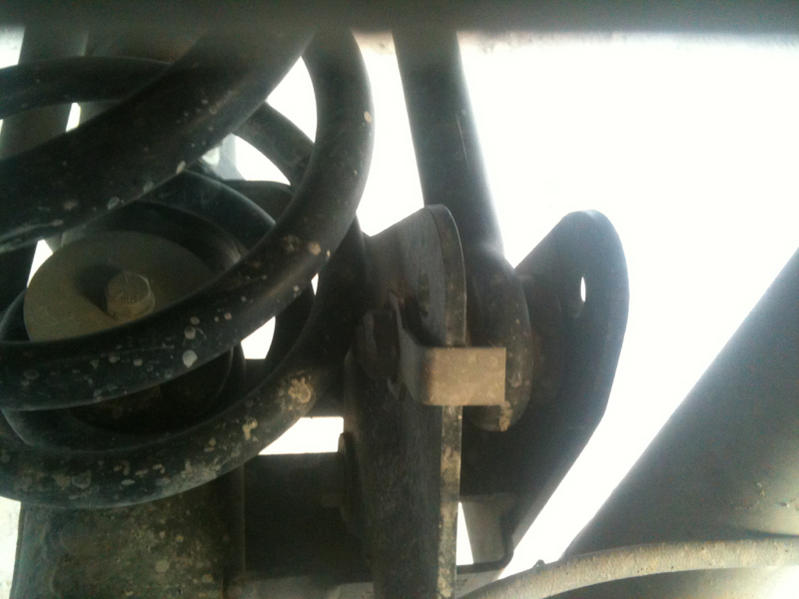

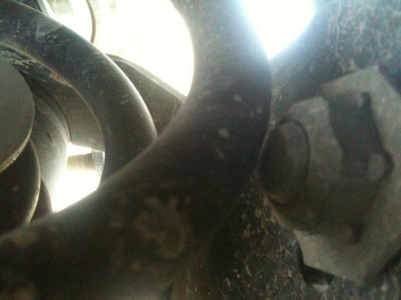

Never thought to check u joint. I will now. What does the teraflex level kit consist of? Seen this other day and figured it may have something to do with it

Check the spring to see if it's scratched at all. That might be your problem

Coil isn't scratched
