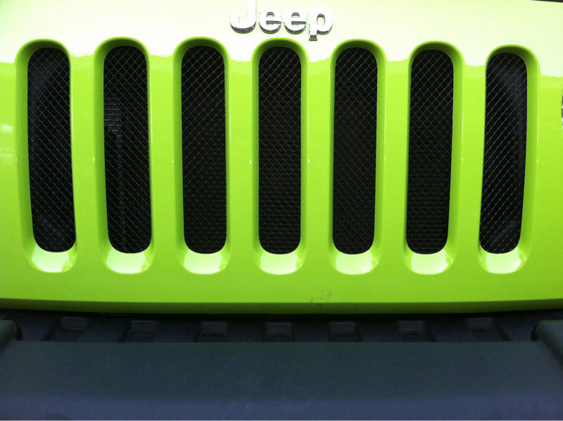

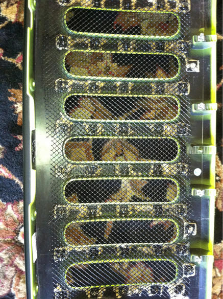

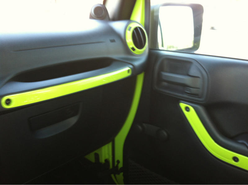

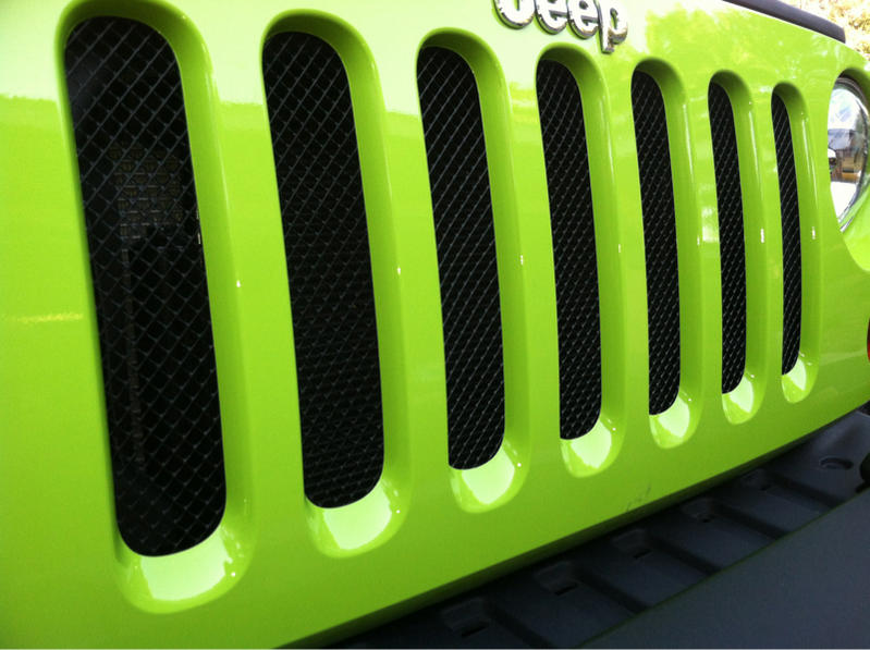

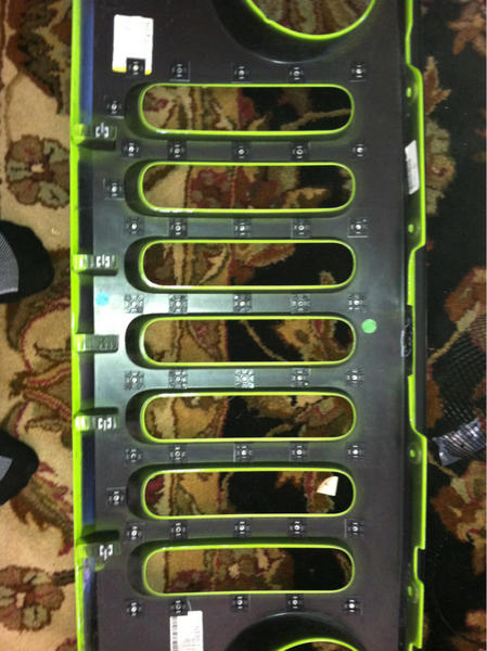

Just finished my DIY grill mod about 20$ and painting my air vents handles. Waiting to do speaker/gauges web my next paint can comes in

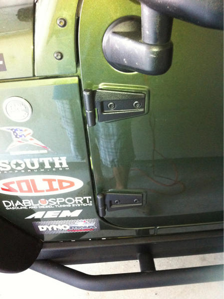

Bed lined my door hinges:

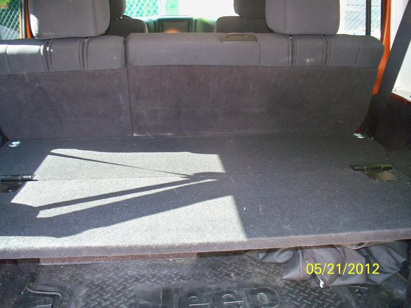

I made this cargo cover over the weekend for about $70. For me it solves a couple of issues. It hides my sub and amp, especially when I'm topless. It's a place to stash stuff when topless, like when out buying things and making multiple stops. It's not a security deck, not lockable or fastened down, but it keeps stuff hidden. It also creates the flat surface that I lost when I put my sub in there to stow my freedom panels on. It also leaves me some cargo underneith when the freedom panels are off. I made it hinged so half folds back to allow me to still use a good portion of the cargo area for taller items. I'm quite pleased with how it turned out. The pics aren't great, took them in a bit of a hurry this morning.
I used:
3/4" MDF
2x2's
Black HD hinges from Home Depot
Cabinet hinges for the two front legs from the Depot
Auto Carpet from Auto Zone
a $1 metal plate from Home Depot for middle support to prevent sagging with a load on top
tie down anchors from Lowes
Spray adhesive
screws

Great mods,looks good, you gave me some great ideas. Thanks.
