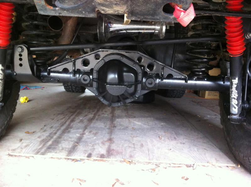

I have the Artec bracket, worth taking a look at very stout..

1/4" steel and welded I doubt it will fail
Attachment 436602
X'2 on the Artec.....I have the same issue and am having this welded on today. Plus the shop is also welding two grade 8 washers on my track bar bracket on the frame side because those holes are wallowed out as well.
Just be sure that whatever you do, you MUST use grade 8 hardware, and be sure the new bolts are 9/16" collared vs the stock 14mm with full threads.

BTW, the picture shown is the rear track bar bracket, but Artec also makes one for the front.
