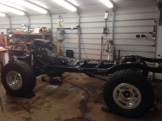

I am in middle of doing the 5.3 swap now with the 6 spd auto and doing it myself using MoTech install kit.
They have made alot of improvements to the kit harness since i ordered mine a year ago. Some of the improvements they have sent me as i move forward with build.
Doing this urself is not for the faint of heart. There is alot involved and alot of hidden costs. When its all said and done, it would almost have been same price to let MoTech do the install instead of me.
MoTech, JSP, several others have these kits and u should call them and ask who thier local installers are near u. They have a network ofpeople they use accross the country.

My donor all aluminum 2010 5.3 flex fuel engine and 6L80e with all front end engine accessories cost me $4600.00
The Motech kit with cruise/bcm package and tcase adaptor was about $6300.00-i got a bit of a discount since i had some of the stuff already with my donor engine
Had to buy new motor mounts-$250 total. The donor engine ones were shot from the wreck.
Had to buy diffent exhaust manifolds-silverado manifolds wont work good, need 2009 trailblazer ones $250 and then powdercoated in ceramic black-100.00
Various bolts/fittings/thread taps and drill bits/wireloom/solder/heatshrink/tiewraps/frame tubing clamps. $300.00
The supplied fuel line stuff was not impressing me-and this is more my problem than anyone elses-so i went and converted both lines to braided stainless steel with 6an fittings-$200.00
Shipping stuff to motech several times
200.00 and that includes insurance and boxing material and padding wraps. Had to send the guage cluster, a/c lines, gear shifter and computers both jeep and gm.
Part of the gearshift cable got left on the shifter and when it was shipped back to me, that part was not there so now i have to buy another 100.00 shifter cable and install that too since the little part cannot be gotten seperatly.
I had the guy accross my street weld the mounts in place and while he was at it, also my teraflex long arm brackets then took frame to powdercoating because it was looking pretty rough after all that grinding and welding. Came out perfect. Better than new!
This is still in progress and i have not gotten the exhaust + catalytics-the stock stuff wont work at all or the driveshafts so thats yet to be paid for.
