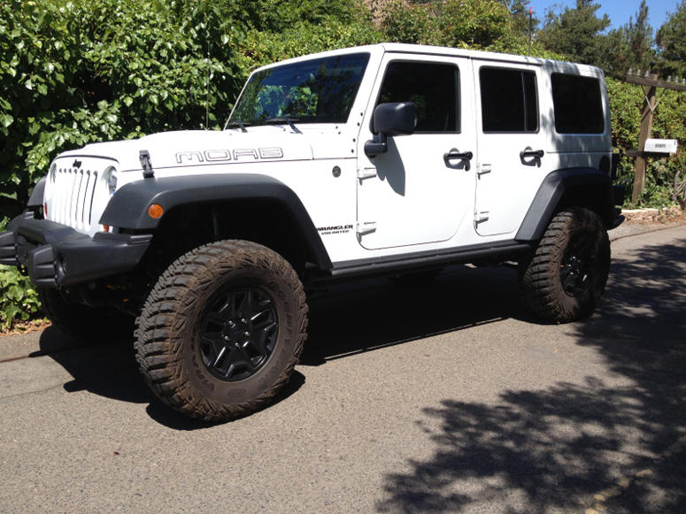

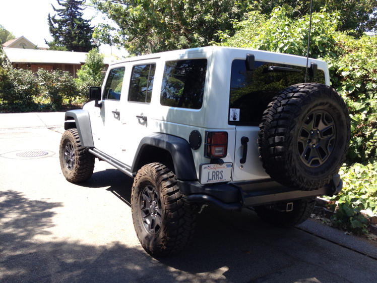

How do you like the Moab? Here's mine with lift and 35's. Put the Smittybuilt winch on the factory Moab bumper in the spring. I love the look of the Moab.
