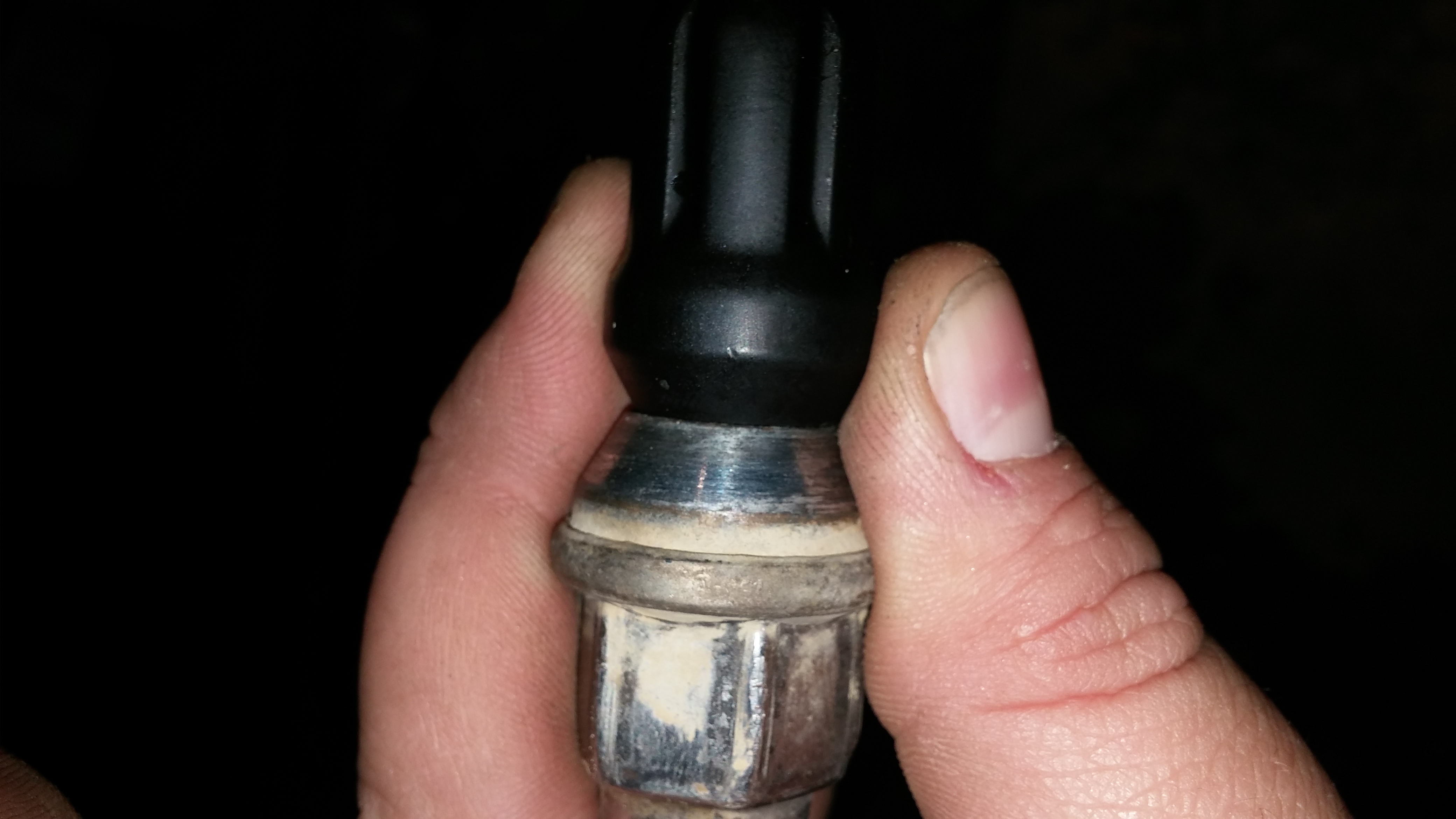

I recently bought new AEV Salta wheels, and from the hundreds of times ive taken my wheels off my stock lugs have seen better days. I ordered a procomp black lug kit and im slightly concerned about the difference in size of the lugs. what do you guys think gtg or not? the slanted part that touches the wheel is a tiny bit smaller. The whole lug is smaller and lighter too.

i personally would get the ones with the larger bulge seat. i tend to be super OCD about shit like this so its just me. I have seen other people run slightly smaller ones with no issues.

Same feeling here. I have what you want on my Jeep, but can't remember the brand. Think I bought a couple spares and kept the package -- will look in the garage.

To funny... my replacement lug nuts just showed today for my AEV Pintler wheels!
A fellow Jeep enthusiast/mechanic pointed out to me the other day (when he was working on my spare tire mounted bike rack), he thought the black Gorilla Spline lug nuts I was using had to small a seat at the bottom for the AEV rim.
After close inspection, I have to agree with him. A few days ago, I ordered some black Rugged Ridge nuts from Quadratech and compared both side-by-side today... definitely a larger seat with the Rugged Ridge.

Default More info...
From WheelProfessor.com » Blog Archive » TECH Stuff # 13 ? ET Lug Nuts. What are they, and why?
This is from a paragraph on the evolution of aluminum wheels and their fasteners...
It was then discovered that the use of a standard lug nut (Acorn Type) was causing problems with the seating area of the wheel. Steel inserts was a solution, but it was soon discovered that the OEM’s were using a Bulged Type lug nut which eliminated the problem with the seating area.

guess ill try the ruggedridge ones, the mcguards are $

Installed the black Rugged Ridge version yesterday on my AEV's... they fit like OEM and look OK.
