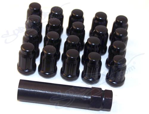

Originally Posted by mjr11
Just bought pro comp 7005 wheels to replace stock 18 inch 2008 Sahara wheels. Can/should I reuse existing lug nuts or should I purchase new nuts as the wheel dealer suggests?
You can reuse the existing lug nuts if you want to. You can get the Gorilla or whoever spline style lugnuts in black. I got mine from Discount Tire they were right around $1.00 each.
I like them for a few reasons:
1. anti theft
2. small profile and wont tear your wheel up with socket during install
3. they are BLACK and go with my anti chrome theme
1. anti theft
Attachment 213704
Those are pretty slick...I'd rather run something like this than 1 locking lug per wheel, those things SUCK IMO.
