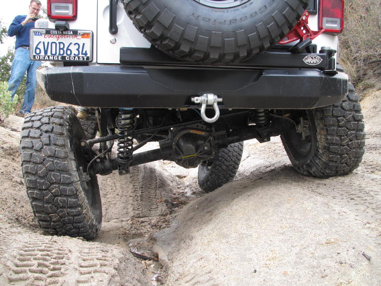

The link wasnt working when I tried,, but I have the JK rear with swing away tire carrier. It opens with the tailgate and there is a pin on the passenger side to keep the tire from swinging wildly closed. also ,, mine has the hi lift jack mount at an angle from the passenger side to the center. THIS IS A GREAT BUMPER!! it is built very solid and was a perfect fit when installed. I have had it up against many rocks and the only result was scratched powder coat. I also like the built in hitch. The only problem with mine was the heim joint attaching to the tailgate would go bad and start to rattle badly every 6 months,, give or take depending on how hard I wheeled it in the timeframe.

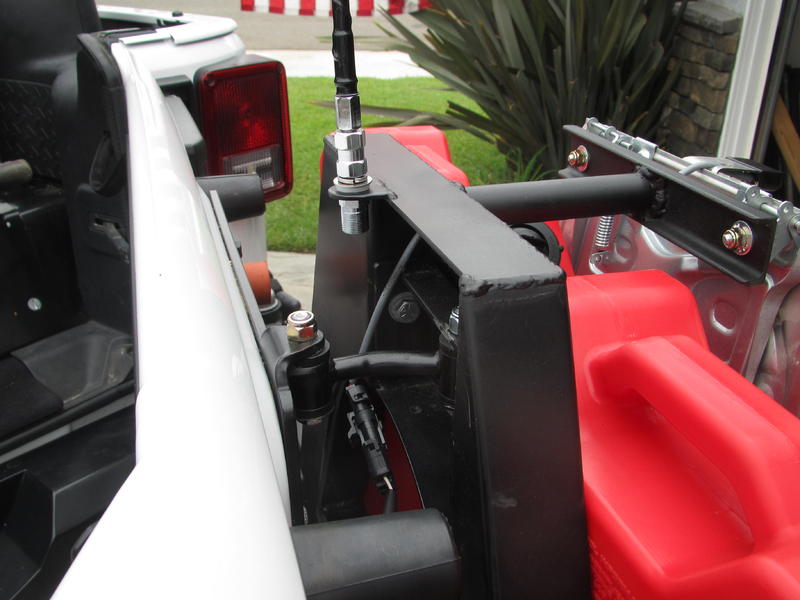

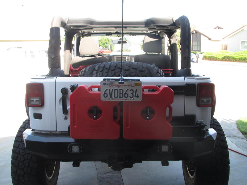

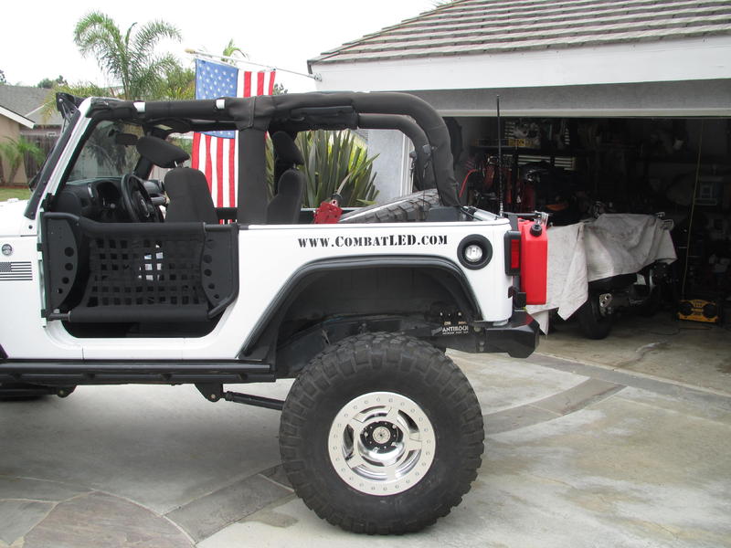

I eventually moved my 37" spare into the tub and modified the swing portion to hold rotopax cans, my license plate and a CB antenna. I also re-worked the connection to the tailgate and no longer use the cheap heim joint MORE provides.
Before and after pics.
Good luck with your decision.
