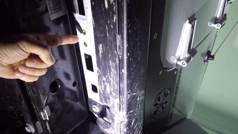

I did a practice piece of sheet metal before I read this thread. It was pretty thin which probably made things a little more difficult. I crimped it, it spun a little so I crimped it a little more, it barely spun so I crimped it again and bent the threaded mandrel on the tool. So if you're close, use very small adjustments. Side note : blind rivet supply has a minimum $15 order. The mandrel is about $5. So I ordered 3 and had to pay $9 for ups ground. So that was a $30 mistake.

Default all done
so before I made the mistake of using a full stroke on the second bite. I only needed an extra quarter stroke or so. I ended up setting it to about three sixteenth and that still wasn't enough.when you take a second bite on it you can really feel it telling you to stop. I use this method for all of them and it was quite easy as long as you don't go further at all once it stops. I did practice a few times underneath the Jeep between the door and the frame.
