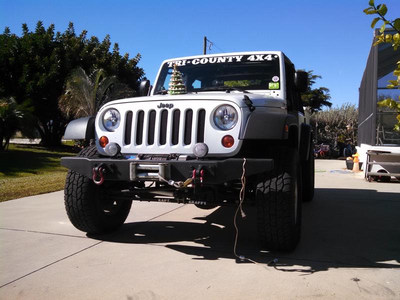

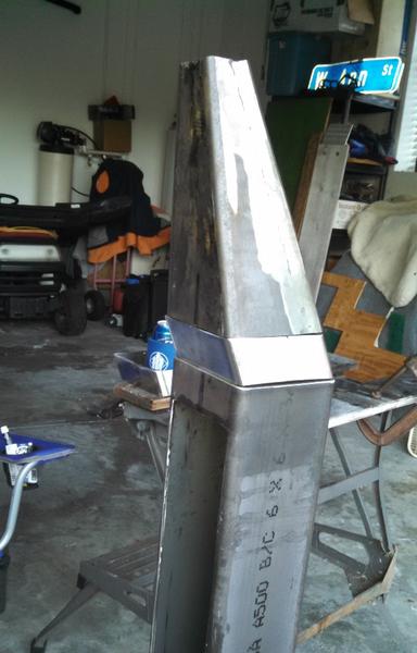

I use 6 X 6 X 3/16 steel square tubing for most bumper builds.
It's cheap, I pay about $10 a foot for it and usaully only need 6 feet for a JK bumper.
Here's my last one.
Starting the first cut.

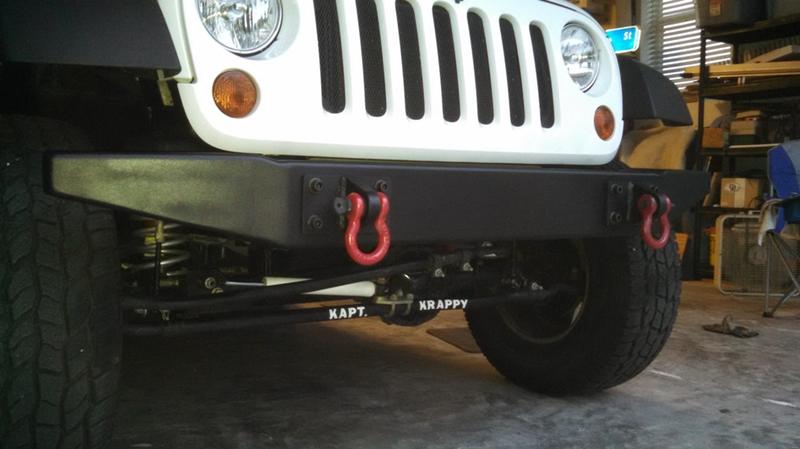

Pieces fabbed up.
Name:	Front Bumper 3.jpg
Finished and mountedwith Ballistic Fab D-Ring mounts
Name:	Front Bumper Done 1.jpg
I then cut in for a winch.
Name:	Front Bumper Done 2.jpg
All of this can be done with a cut-off wheel, a grinder, and a welder.
I use Rustoleum bed-liner in the spray cans for the finish coat. I like the texture the best.
Oh, this bumper weighed 55 lbs when finished. 1/4 inch steel would have brought it up to about 70 lbs.

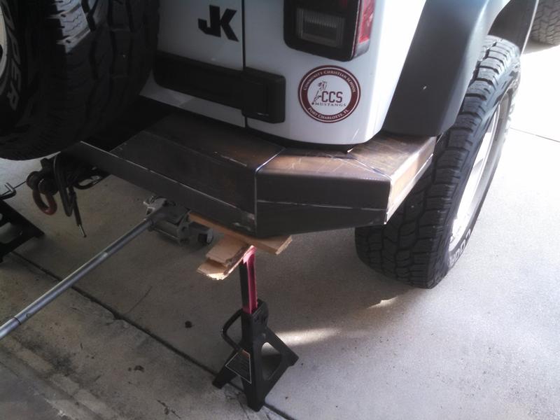

I like it because it has that round finished edge.
here's a rear bumper I'm working on now.

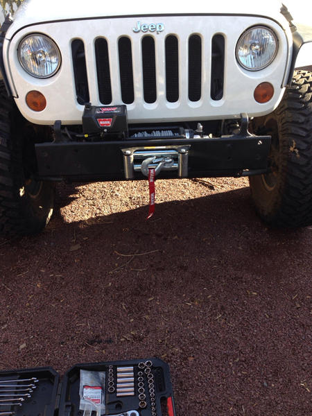

JKBud's Avatar
Joined: Feb 2013
Posts: 298
From: Essex County, NJ
I used 3/16 on mine.
