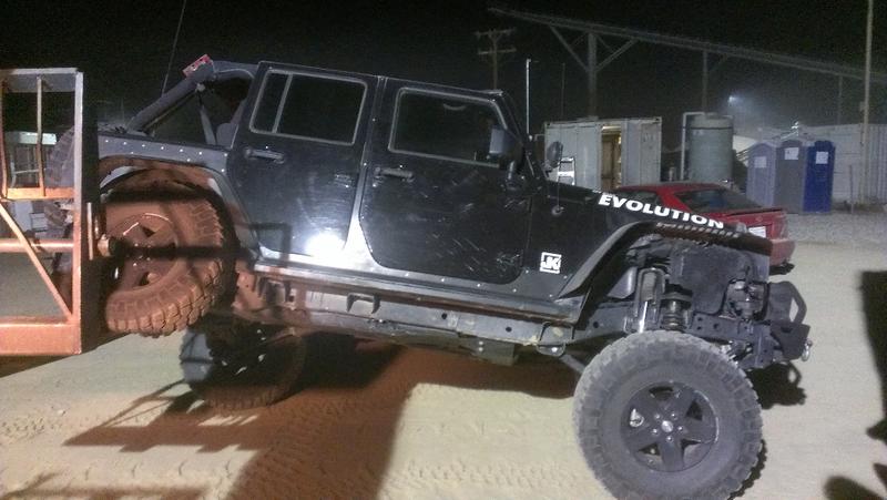

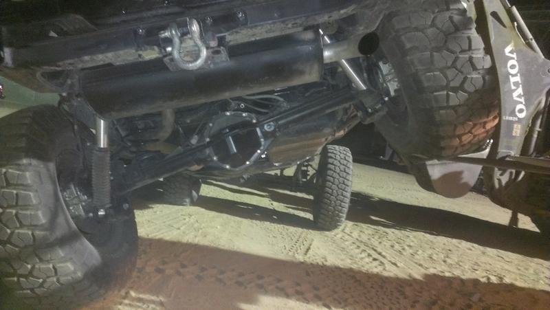

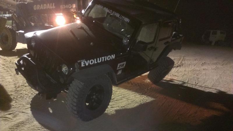

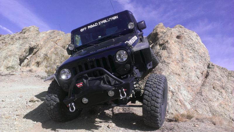

Here's my setup-
tf 2.5" lift with 2.5 rk coils in the front.
1.75" front bumpstop
2.5" rear bumpstop
Front lower spring retainers
Rear lower and upper spring retainers
Trimmed frenders,pinch seams and rubi sliders
11" long front sway bar links
9" long rear sway bar links
Bilsteins for 4" lift up front
Bilsteins for 2" lift in rear
EVO rockstars lower shock mounts
1.25" rough country body lift
37" BFG km2's on stock wheels
1.5" spidertrax wheel spacers
