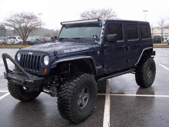

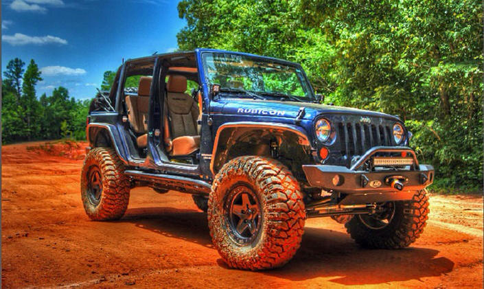

I put 18k miles on the game changer lift and was very pleased. The on road ride was fantastic for a jeep on 37". I had the 3.5" kit with 3/4" spacers on all four, poison spyder crusher flares. At max stuff, with 3" bumpstops, I rubbed the flares. I still got the max out of it without the overlines or the over lands.
