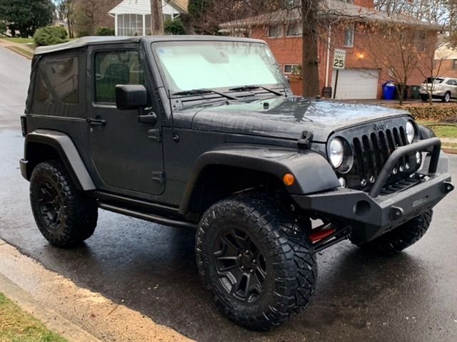

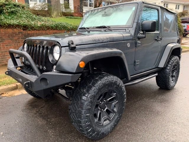

Went with the Metalcloak 2.5” True Dual Rate - Rocksport . . . I could not be happier!! Paired it with 33” x 12.5” Nitto Ridge Grapplers . . . The ride is better (more precise without being to tight or stiff) than stock.
