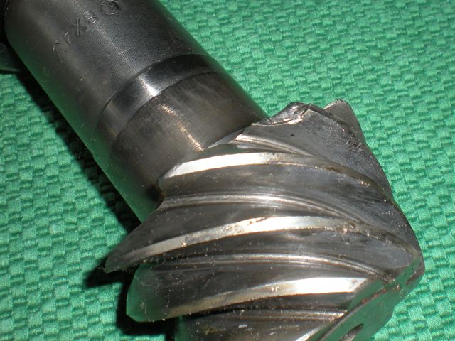

o man, I know that picture very well, I am sorry to see that,
check the casing of the bearings,
that's what I found in my case - the casing was ripped of and damaged but still keeping the bearing together, the reason for damaged casing was still broken gear but shreds like that are from soft metal pieces milled by gears,

I reviewed Mituk’s pictures and I think I have the same problem as he had. I pulled both axle shafts and they look great. The right one had very small pieces of metal on the splines, but no damage. I suspect the pinion gear is toast along with all of the bearings. I’ll need to pull the carrier to check the pinion. Mituk also said to check the backlash prior to pulling it.

I took the jeep back to the installer. The pinion gear is toast. It looks just like Mituk's pinion in the post above.
