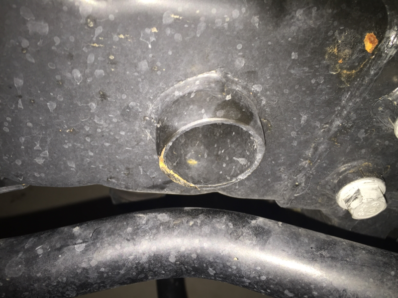

Anyone else had their sway bar hit this piece on the frame??

Anyone else had their sway bar hit this piece on the frame?? <img src="https://www.jk-forum.com/forums/attachment.php?attachmentid=629564"/>
That has been happening on Jeeps since 06. Just file it down.
Everyone. Sway bar shifts side to side. I tried grinding at first and then it kept happening. Cut them leaving a little outside the frame and all was well.
What's the best way to cut it??
Sawzall works well.

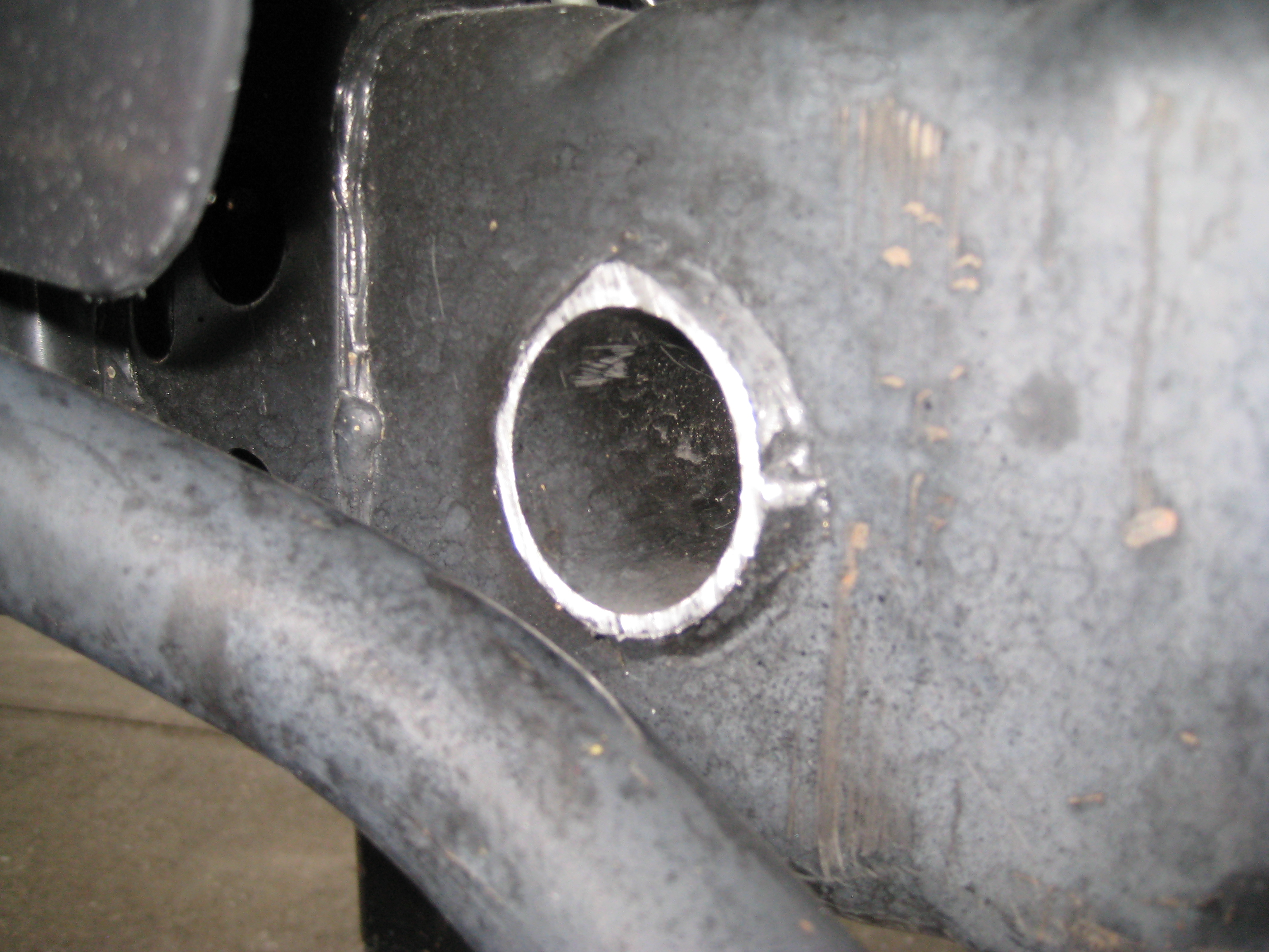

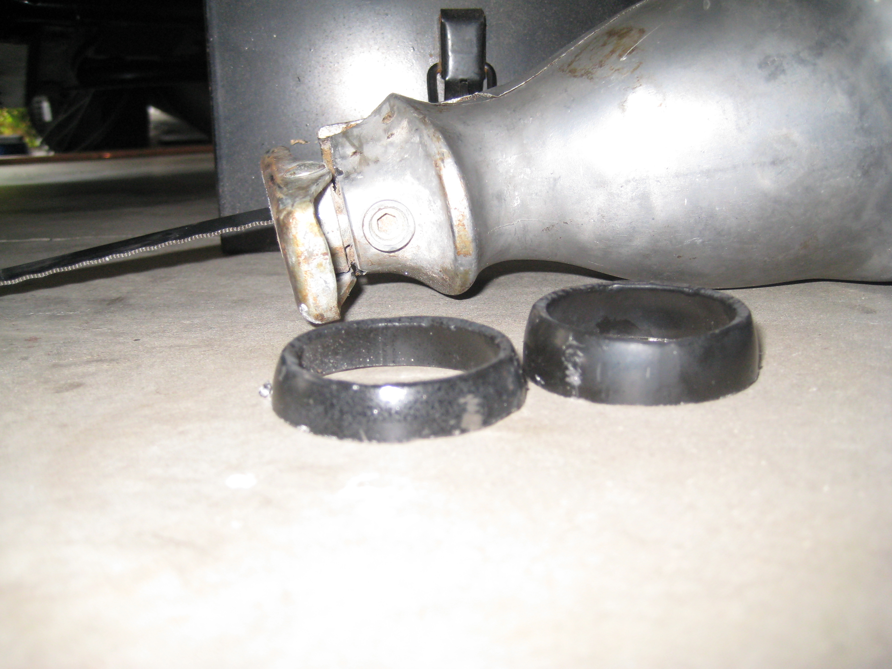

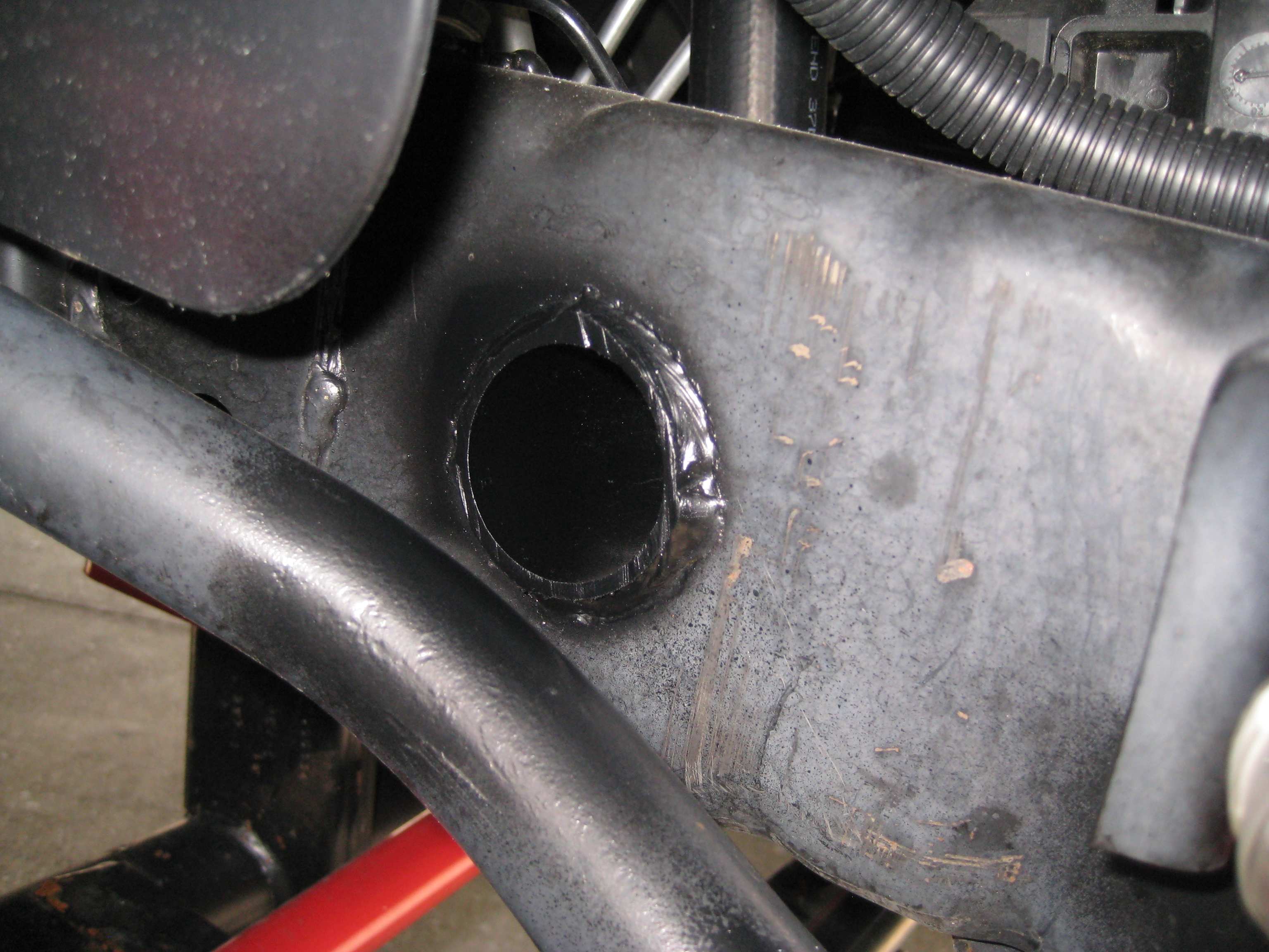

Sawzall works well.
I did the same. But since I have been told by another member that the purpose of that bar is to keep the sway bar aligned and not going too far side to side. Hasn't been an issue for me though so
When it hits dose it make a sort of click or cluck rattel sound when going over speed bumps or pot holes slowly. That sound has been driving me nuts I'll have to look into this
