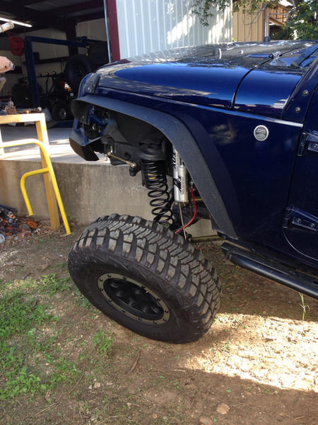

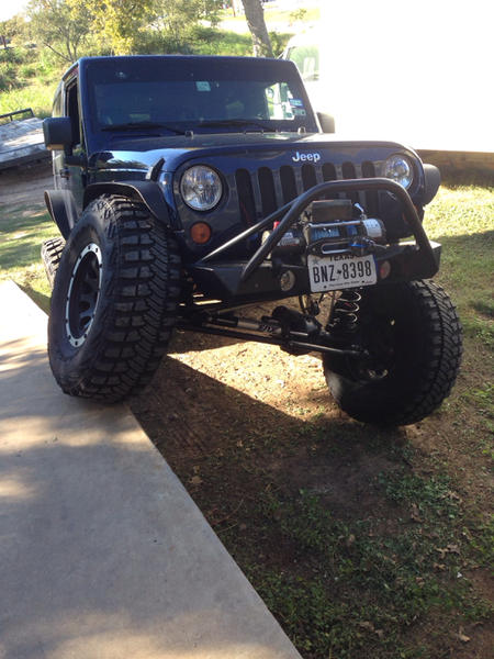

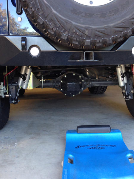

Originally Posted by Lusky
Added Fox 2.0 w/ resi to my 3.5" MC lift.
Attachment 507646
Attachment 507647
Attachment 507648
Correct me if I'm wrong but the pic with the driver side full droop it looks like the shock shaft is bending, which means the shock body is hitting the frame Take a peak with full passenger droop also as that's where I had my problem of the shock body hitting the frame and bending the shock rod, thankfully the Bilstein's shock shafts are cromoly and bend back

Nemesis makes a bracket that bolts on to change the orientation of the bottom shock mount by 90° and it also buys you additional droop, albeit you lose some uptravel.
When my PR 44 arrives I will be moving the bottom shock mount outward x 1 mount width to solve the problem. I don't have a front drive shaft installed right now and test flexed this one time with the new shocks. The shock body is hitting the frame in this pic where the shaft is bending.

I hope you ordered that pro rock 44 about 3" wider then stock. It will be a much better fit and will give you more room to widen out your brackets. Did you order the tubes naked so you could weld your own brackets on?
I installed the Nemesis front lower shock mounts on mine to fix the problem... till I can swing a set of Metalcloak Sixpack shocks
