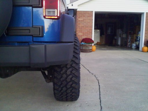

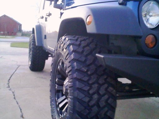

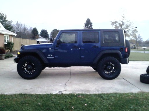

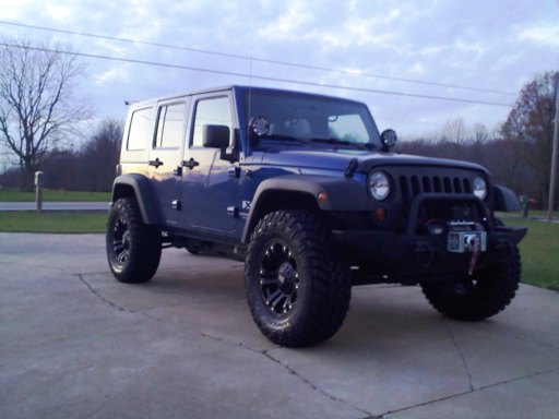

I'm running the new Nitto trail Grapplers. 35 12.50 18 and i love them. If your not wanting noise then don't get a mud terrain. They hum. The trail grapplers, toyos, ect will have a slight hum to them, but some aggressive all terrains will hum also. Duratracs seem to be the cross between the mud terrain and all terrain. You may wanna look into those. I'm more of a mud terrain guy. I liked the Duratracs and was about to drop some coin on them but decided i just wanted a mud terrain. No winter driving in them yet but i'm hoping they will be ok. No mud terrain is great in snow. You just gotta drive with caution. I went around and around 2000 times with what tires i wanted. I'm happy with my decision. My rims i went with XD Monsters 18x9 with 4.5" backspace and i have no rubbing at all. I'm running a 2.5" RC Series II budget boost.
