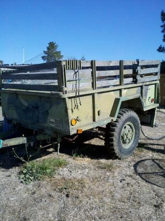

I'm looking at these 2 trailers and wondering how I can get my hitch to work with them. Any ideas? The one has the donut shaped ranch style hitch and the other has a pin style hitch. My Sahara has the towing package and 2" receiver. I'd rather not change out to a new hitch on the jeep just for this trailer because I tow various other things with a 2" ball
Is there any adapter that can go from my 2" receiver to either of these hitches?
If I take the ball out of my drop hitch, does the pin hitch style one just drop a pin in thru the hitch and my drop hitch tongue?
Should I just cut and weld in a 2" ball hitch on the tongue?
How much should these be priced at? The top one has a few rust spots that have eaten thru small parts of the body but both are in good sturdy condition and frame and suspension and tires look good for being 50 years ol
Thanks in advance
People are asking 1,000 for this one

People are asking $750 for this one
