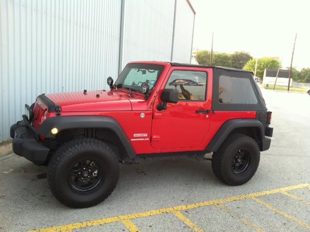

Old Jul 6, 2012 | 01:32 PM
Redjeep1's Avatar
Posts: 29
From: Missouri City, TX
This is my jeep with 285/70-16 Nittos, I added Unlimited Rubicon springs to it which bumped it up just under 2". The tires would have fit fine though without it since they only measure 32" tall installed.
