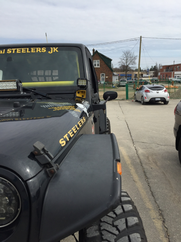

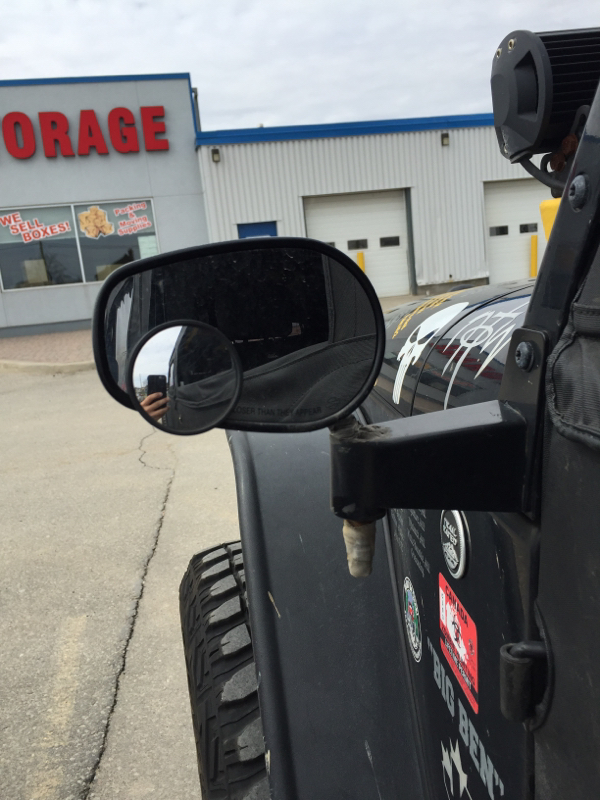

Harley Davidson bike mirrors on my jeep... Just had to use a couple extra nuts and washers to fill the gap .... I also filled the hole up with silicone to keep water from getting in.... And if you bump it on a tree off roading there's some give ....Mirrors don't move in the wind at high speeds either. Looks cool imo from the front too a different look.
