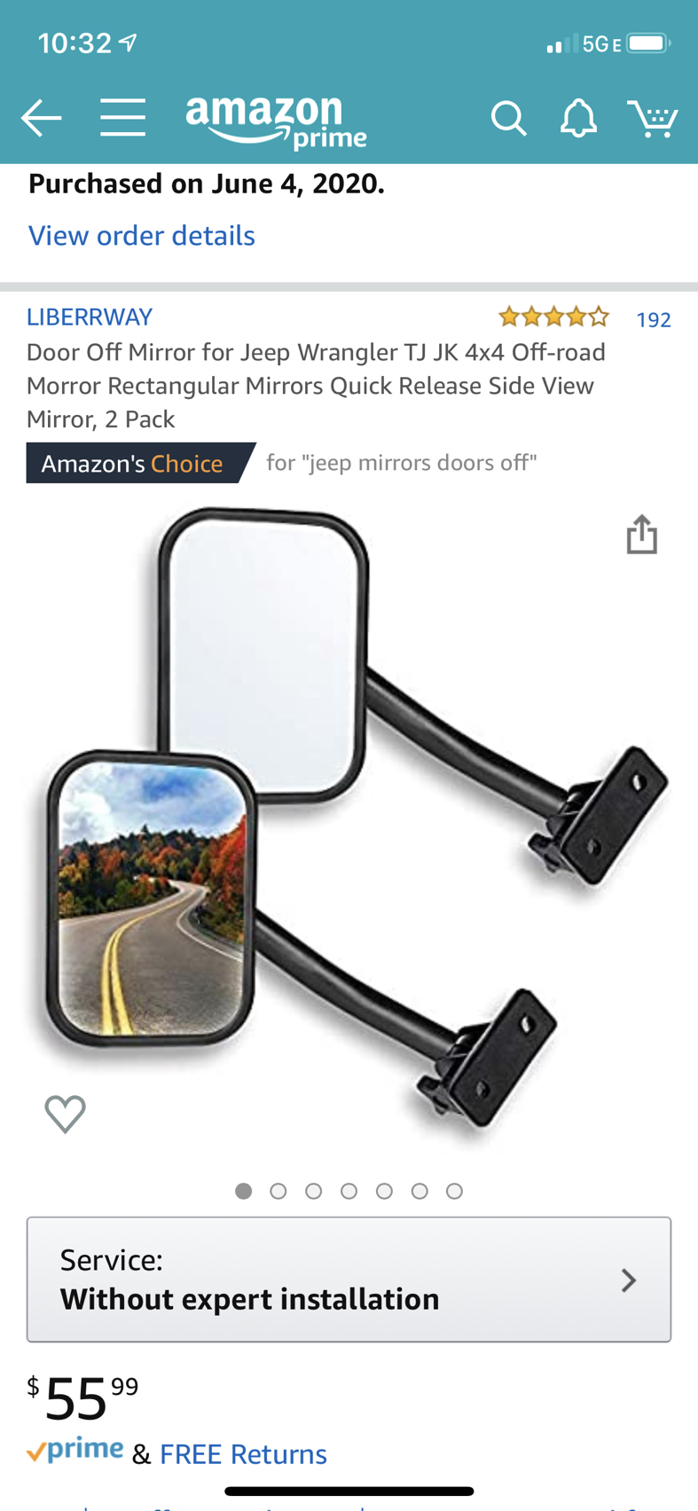

Can you share a pic of your installed mirrors? How much did it cost for the project? I had the round mirrors for two seasons and I thought they sucked. Very limited visibility. I just replaced them with rectangle shaped ones that have a slight convex mirror. Wow, what a significant improvement. So much more field of vision compared to the round ones.
