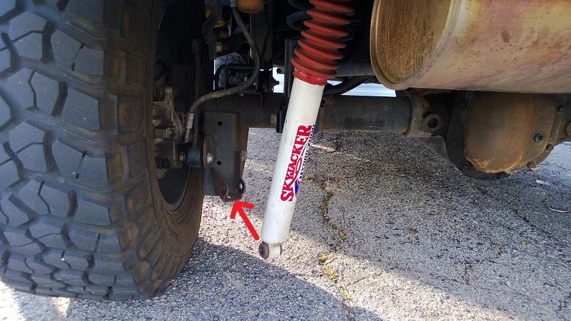

Name:	Shock Bolt Missing.jpg
Someone pointed this out to me today! Should I buy replacement hardware from a store like Pep Boys or Lowe's?
Thanks for any info!!!
Old Jan 30, 2013 | 04:04 PM
Zombie Hunter's Avatar
Posts: 522
From: Linden, VA
I would. Grade 5 should be fine. Use a lock nut.
Someone correct me if I'm wrong.

Thanks Zombie! I think I'll replace all of them with lock nuts...

Looking for install instructions to get bolt/nut size. Anyone happen to know what they are for the Hydro 7000?
Take the bolt off your other shock and take it to lowes or home depot and find a matching one.

X2 on this.... Local hardware store will have what you need.

Don't listen to these clowns. I would go to a hardware store like Lowe's or Home Depot and find a matching one. Might even take off one of your existing shock bolts for comparison.
