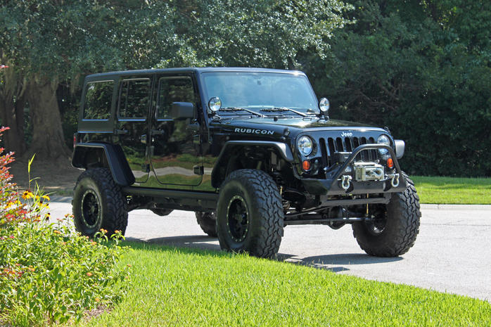

Spacers up to an inch are a good way to get back the height you lose with heavy bumpers and armor. The lift specs are never exact on springs because of the variances in weight. Most kits actually lift a little more (or a lot more) on lighter Jeeps than the advertised height.
On my 2DR Sport, the 3" lift netted over 4" until I added bumper, tire carrier, winch, etc. Now it's maybe 3.75".
Even my 4DR loaded down pig Rubi was over 4" with a 3" lift and 3/4" spacers...
