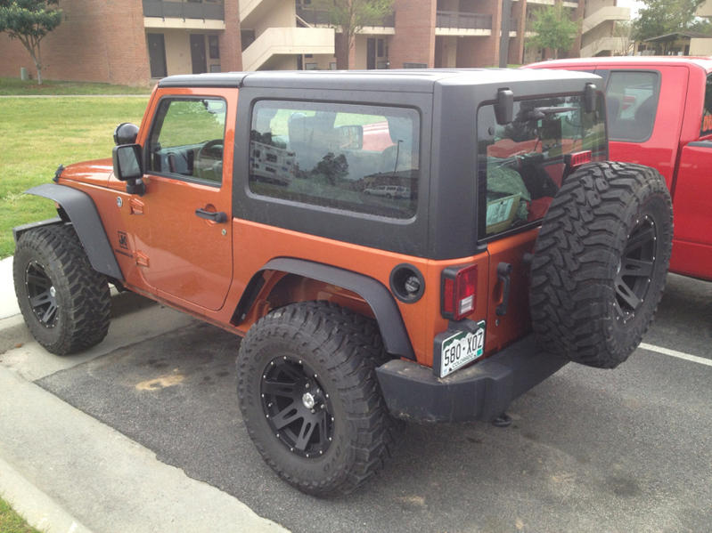

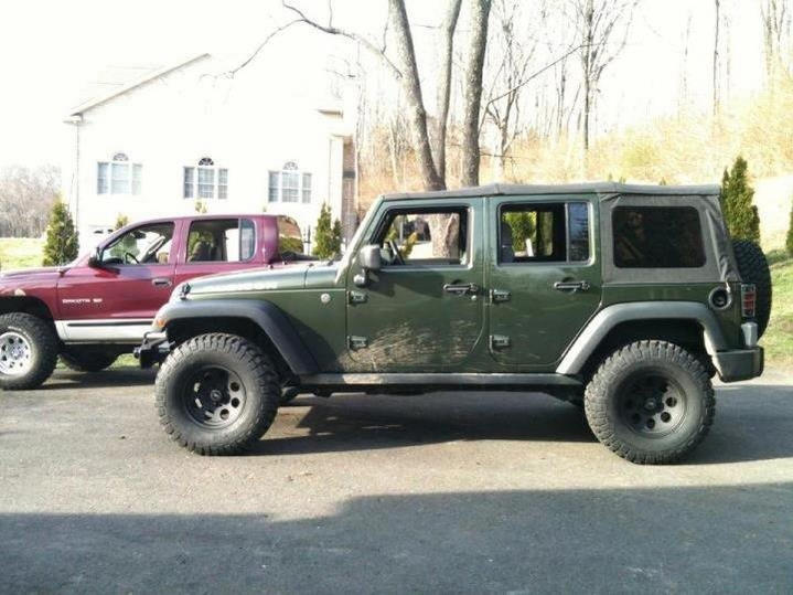

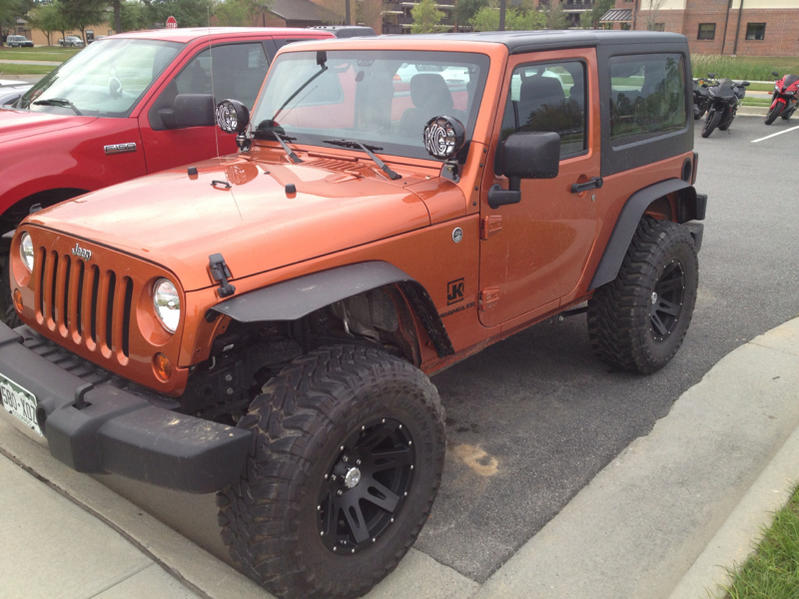

I run 35s on mine with just a teraflex leveling kit and chopped fenders and it works awesome
