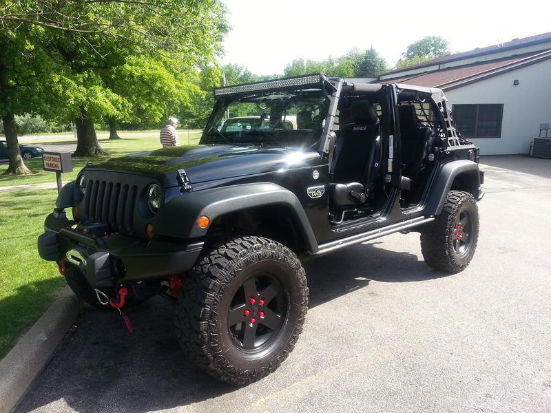

I've been having some electrical problems. With cruise control engaged, I will have everything electrical shut off for a split second then come back on. The speedo and tach drop to zero then spin back up, radio goes out, and it kicks me out of cruise. Also, when I turn on the turn signal my windshield wipers engage once. I've read on here that it's possibly the TIPM.
Anyway, I took it to the dealer yesterday for service.(warranty) The service manager called me today and said the computer showed a bunch of trouble codes but they don't know which ones were caused by my mods, and which ones might be causing my problem. The only mods that I've really done are adding a lightbar, JW Speaker headlights, LED fogs, and I ran some LED's up under the wheel wells and wired them to the dome light. I also have a 3.5" lift on it too.
I have a bullydog programmer that hasn't shown any trouble codes when I checked. Could my lighting upgrades cause a bunch of trouble codes like the dealer said, or is that just an excuse because they can't figure out what's wrong??? They called today and asked if they could hook the computer up to it and drive it around to get some readings. I figured I'd get on here and ask.
