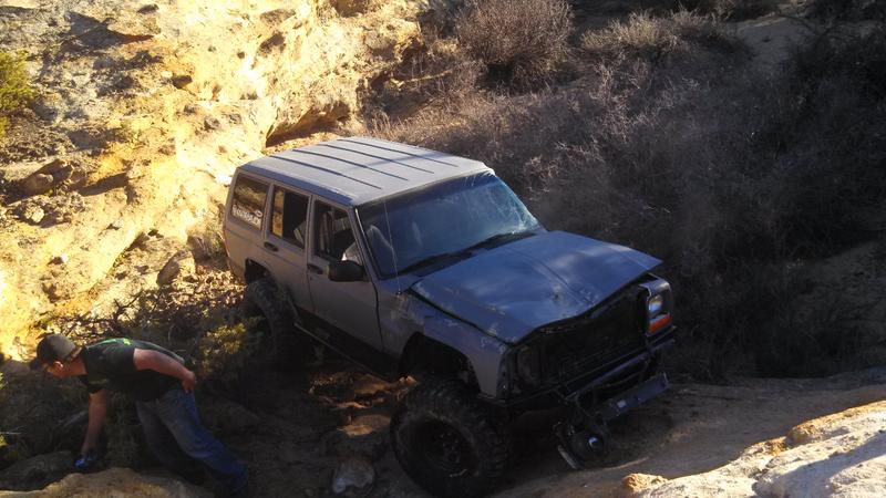

Its pretty tough my buddys whole xj was covered in it and he is doing the same to his mj. It doesnt cost a ton and he did it himself. We rolled the xj and totaled it but the lining held up surprisingly well.

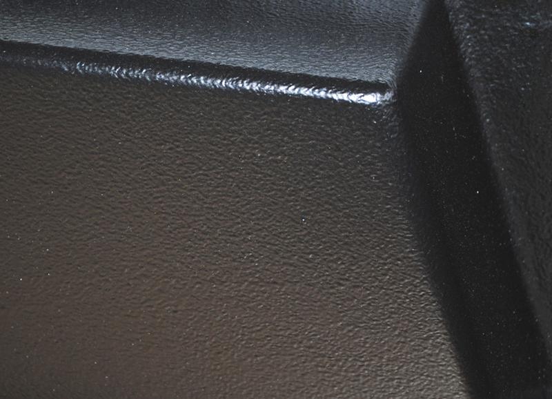

It's good stuff and comparable in price to Herculiner. I did some fenders on a trailer of mine and it worked great. This material seems to roll on much thicker and with a better consistency than others I've tried. Prep was fairly easy. Taped off the edge you want, use the sanding pad that comes in the pack to rough up the surface. The Monstaliner has a nice balance between rougher texture and smooth texture. You can run the roller over the liner after it is slightly dry to get a rougher texture if you want or leave it smoother. I'll see if I can dig up some pics but I wouldn't hesitate to use the stuff again.

Just black but lots of tints available

Here was the Cherokee. It was grayish.

I like the look of that texture. It looks like a crinkle powder coat that came on a bestop bumper I had on my old TJ.
