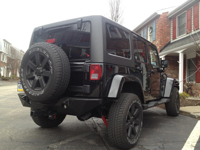

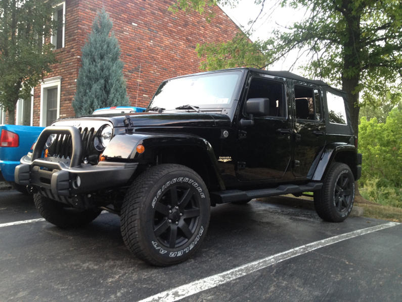

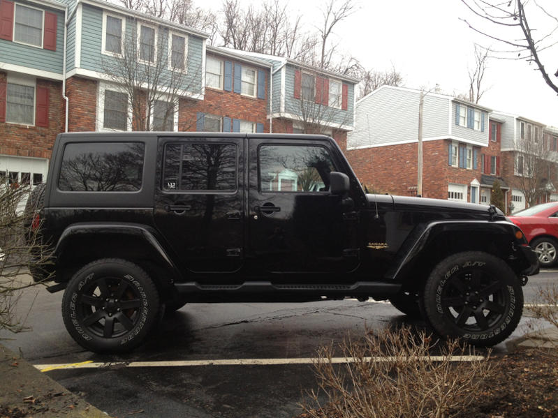

If it helps I'm at 38.5" on all four fenders with AEV and PSC bumpers. TF leveling kit with 19/60 springs and red Rubi shocks. The change in ride was very noticeable, much firmer, very nice.
Attachment 414937
Attachment 414938
Attachment 414940
This is helpful. 38.5" from where to where exactly?
Thanks!

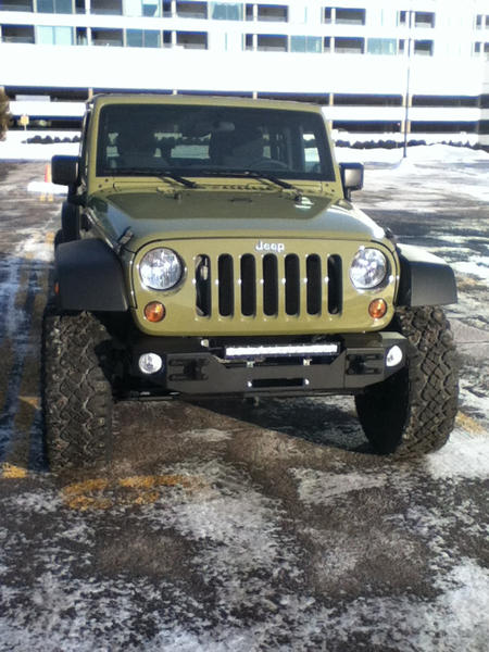

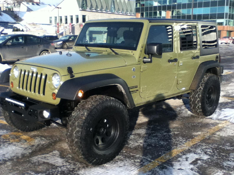

2013 JKU
This is 315/75/16 GY Duratracs that measure to 34 5/8 with rubi coils 19/59 and a Tera flex spacer lift . Hope this helps
Thanks!
Measuring from the ground using the axle as a centerline to the lip on the underside of the fender nearest the "edge" (note there is no true "edge" on the plastic fenders, it's as close as I could get to similar measuring points).
