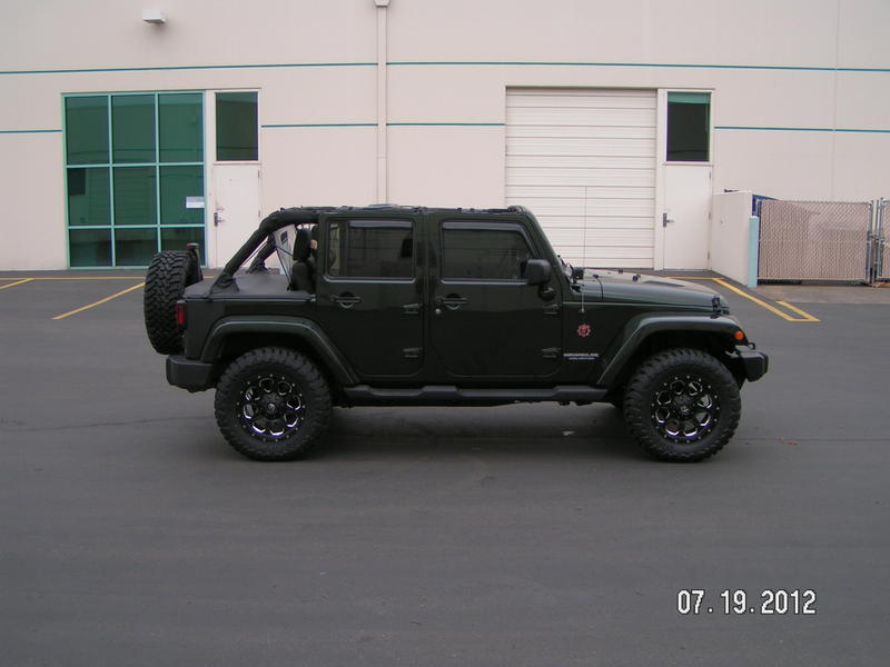

Hedgehog.....Quite simply the 2" lift from Mopar isnt worth $1500....But if it is backed with a Warranty. Take it! Thats what Im running on my JKUR X. My only recommendation is to go with upgraded shocks if offered. Currently running 35 x 12.50 Toyos on Fuel trophy. The ride was stiff before the bigger shoes on stock rubber. Currently it is firm, but thats with Pressure dropped and I assume the coils have settled in a bit. Its a fine line to find what is acceptable on road vs off road. I find paved roads a little stiff, but once she hits dirt I am very satisfied! I am currently getting ready to go to flatties to open up the wheel wells. I have yet to run into any issues when disco'd offroad with the current set up. To have any issues covered by your dealer with a lift is worth it to me. Especially for a new vehicle. But mind you.....There are many similar systems out there with better functionality and cheaper price! Go for it! Run the Warranty out of gas and then upgrade! If your dealer is open to just a puck style leveling kit. I would go for it. If you are only running 33's and staying on pavement. It will fill the bill. The second pic is of the 11' sahara on 33's with a level kit.

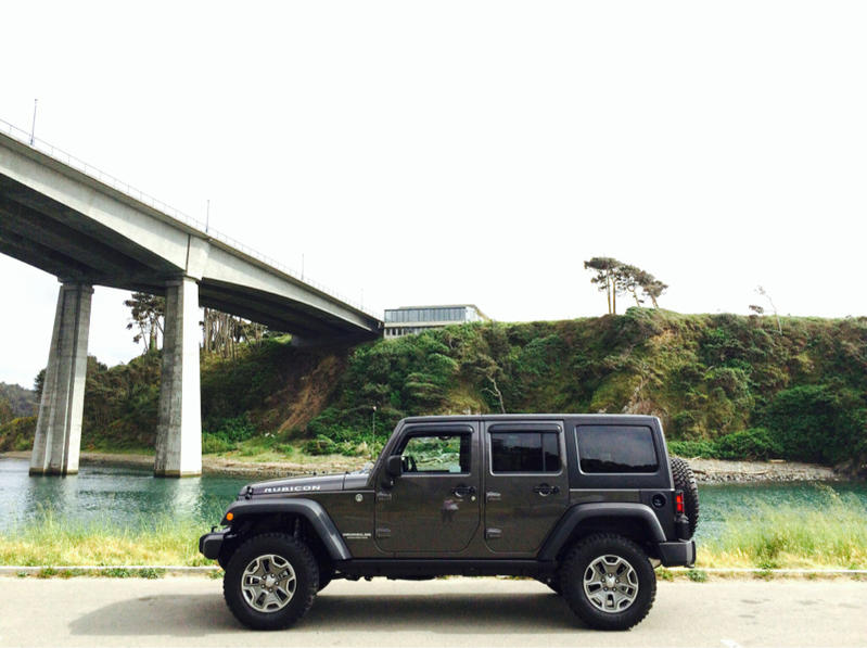

I got my rubicon on 3weeks ago and it came with
ID:	551043 this. nways, I was wondering if i can run with 35's on it w/o doing anything & still have a comfortable drive? what's the best thing to do?
