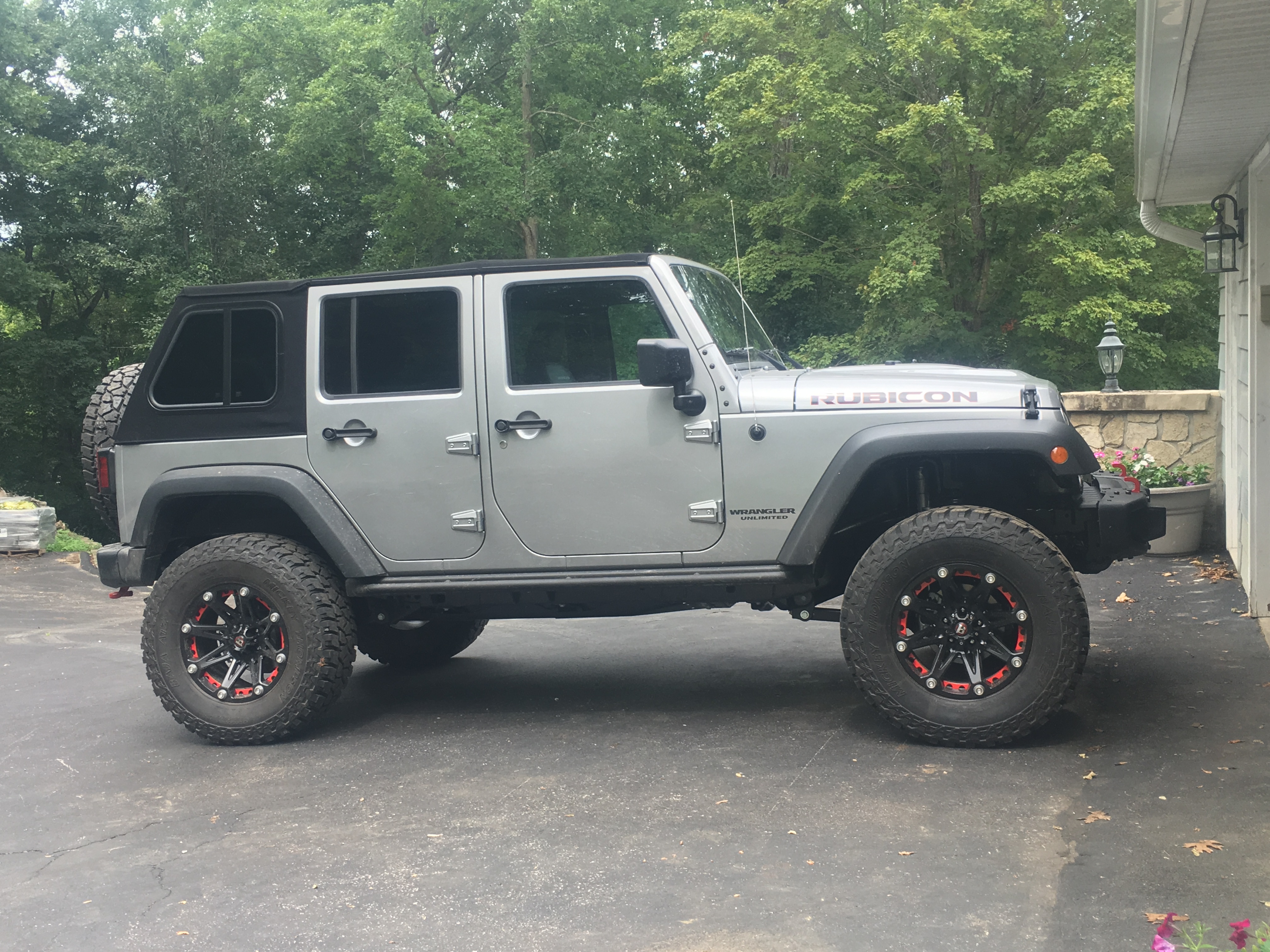

Dealer installed 4" mopar lift. I did not like how it drove and added the aev kit it made a huge difference drives much better now! Have 35" ATZs

Dealer installed 4" mopar lift. I did not like how it drove and added the aev kit it made a huge difference drives much better now! Have 35" ATZs <img src="https://www.jk-forum.com/forums/attachment.php?attachmentid=652905"/>
Sorry, just want to clarify your post above...
You added the AEV geo correction brackets? Or you changed the Mopar lift to an AEV lift?
Disregard... Just saw your Sig line! Makes sense to me now!

Yeah and totally amazed at the difference the brackets made!
