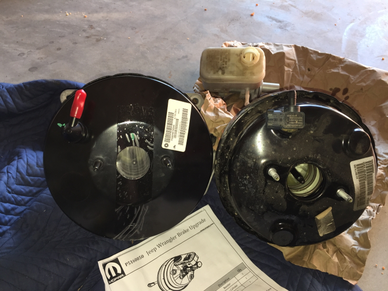

I am attempting to install the new brake booster, master cylinder and reservoir part #P5160050 and there is no electrical connection on the new booster where the vacuum hose attaches. On the pic the new booster is on the left. Can I take the piece off the old one and put it on the new booster? Is it universal like that? Super frustrated as I've already taken it all apart and don't want to just put the old one back in because of this. After I install this I was going to install the P5160050 (rotors, Pistons pads etc)

I pulled off the one one the old booster and put it on the new one. Hope it works

Did you watch the TF install video on YouTube?

I watched the BCB YouTube video. But that one also didn't have the electrical connection. I pulled the vacuum hose price out of the old one and outfit in the new one so I think I'll be ok. Just was not mentioned or included in the instructions. My guess is the 2012+ booster is different than 07-11
