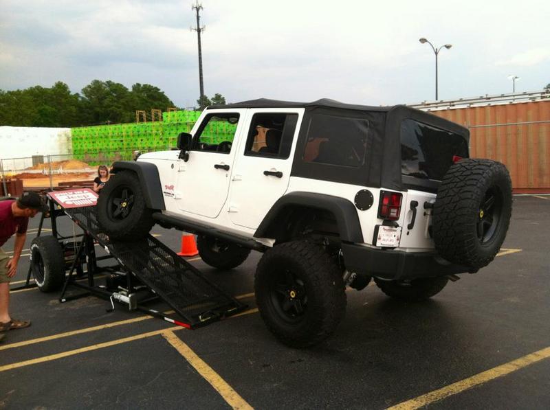

I have the 3" MOPAR/Teraflex lift with the fox. It retains the ride/handling qualities of a stock jeep on road, when you get off the road this lift shines. You get a great deal of flex and the shocks perform well. Im running 35's but my friend is running 37's but his is a little tight under the fender. Also I get 2 mpg better them him but mine is a daily driver. Now that MOPAR is putting out some quality components its definitely worth it. and there is the warranty thing

Here is a poser pic of a flex test

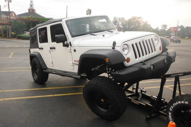

and one more of opposite side
